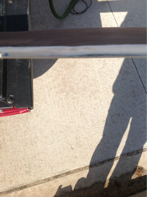

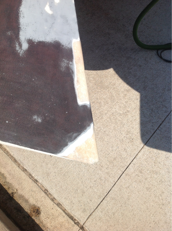

I've sanded the rudder with 80 grit. In the process I found 2 areas that justified further investigation. I found a minor 1 inch spilt on the trailing edge and some pitting on the bottom trailing edge corner. I'm planning on using epoxy resin, and filler to fair then glassing over the 2 areas. See pictures. To expose these areas I removed bottom paint, primer, gell coat. For final finishing, can I just prime over cured resin and then bottom paint? Any thoughts? image-3595314464.jpg image-2335839799.jpg
