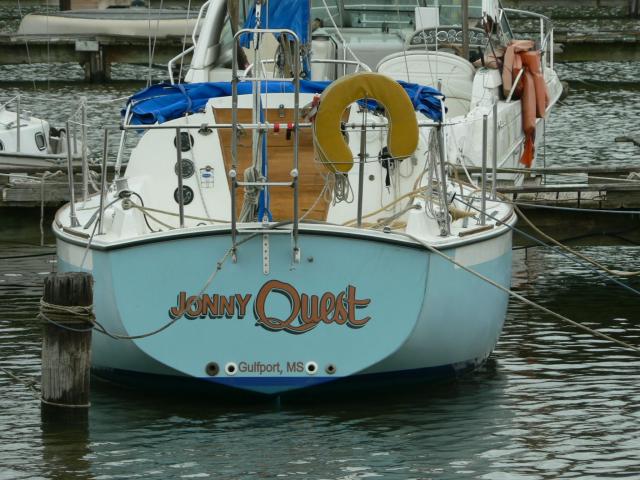

I have never used butyl tape, and for that matter have never rebedded my deck hardware--but its time.
How many rolls would be needed to complete rebedding on my sailboat? and does the left-over tape have a shelf life to last? I assume it does. My boat is a 1975 27' O'Day sailboat, and has a standard complement of stanchions, cleats, pulleys, and blocks.
Any ideas on how much to get the job done? Here's a photo to give a general sense of my deck hardware--usual complement of hardware.
Thanks!

I would go with 3-4 rolls. As for shelf life I bought a case of it back in 1998 and as of last spring, before I began selling it, I was still working off that case and it still worked just fine....
