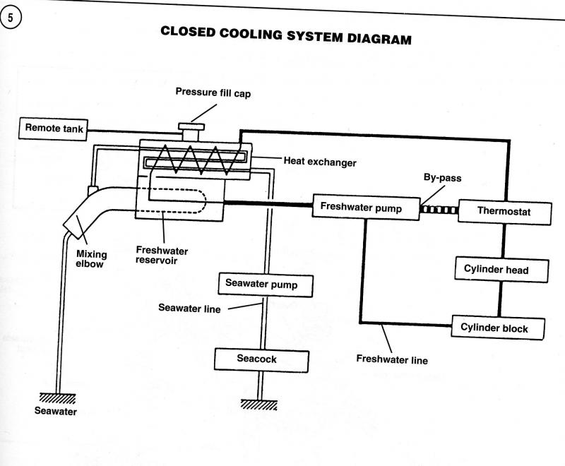

Two different antifreeze locations
it sounds like you may be confused with the cooling system. You have a closed cooling system similar to a car.When you run water through your water intake, muffler and out the exhaust, this does not get into the engine. It just displaces the raw water from the system. When you look in the reservoir, that is the coolant that actually runs through the engine and it sounds like you are short on antifreeze in the closed system. I think you are going to have to drain that and add more antifreeze there.

Joker, your diagram does not include the water muffler. Most of the AF needed to winterized a marine engine is consumed by in the flushing of water from the muffler with AF. I could easily winterize my HX/raw water circuit with 1.5 gals of AF, it takes 5 because of the muffler volume.

The mixing elbow is part of the exhaust.
Here is the page from the 331 manual showing the muffler.
Mine only takes 2 gallons before the the pink stuff comes out the tail pipe
