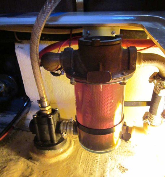

I have been "freeze proofing" my three cylinder Universal for 25 years. Many years ago I replaced the standard engine thru hull with a two way valve version that incorporates a standard hose fitting on it. I have a length of tubing clamped to a 'garden hose' fitting that screws into the top of the thru hull fitting.
That tube is inserted into a one gallon bottle of Pink Stuff RV antifreeze. Engine is warmed up, and then while running @ idle the valve is turned from outside water to the inlet port from the bottle of 'pink'.
A short time later I observe some pink color come out the exhaust and stop the engine. This takes about 3/4 of the bottle.
Thus the system is protected from thru hull, strainer, heat exchanger, and water lift muffler... all the way to the transom.
That nifty little engine intake thru hull is then rotated to "off" until spring. It is a Forespar product, and a great design. (IMHO)

Here is a link to our system:
