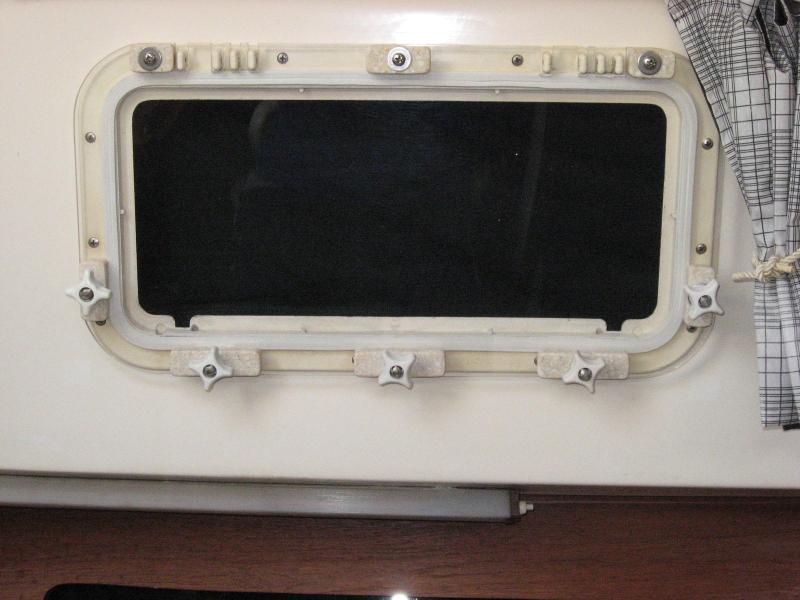

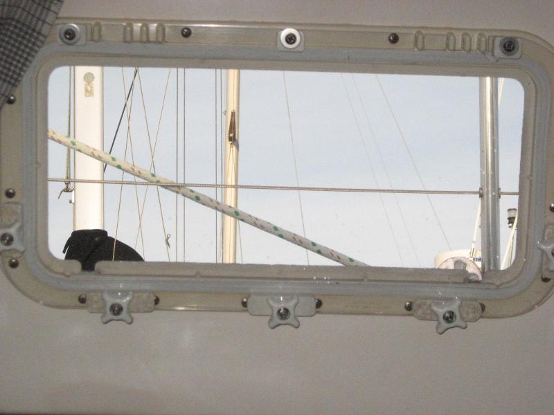

I agree with the "it's subjective" response.
For my marina and general sailing routes (central San Francisco Bay) its cool with low humidity 98% of the time even during summer months.
So, the companion way, deck hatches, and the three forward small ports are plenty enough for ventilation.
That's why I decided on a very economical but time intensive DIY fix for the four biggest port lenses in my salon. But (and a big but) the outside frames on my boat so far have maintained their weather tight integrity. And I am a protected waters sailor so resistance to mega-force waves isn't a requirement while I own the boat.
My DIY lenses don't open (but can be quickly removed if necessary). But because of our weather conditions, it's been fine. Pic's attached.
For your high humidity high temp NJ summers ... I don't know. As already said, your call!
Look in the chandlrey section of the SBO sponsor of this forum . Gray port replacement lenses are being offered at what I think are very reasonable prices. If I had seen the offering before I did my DIY solution, I would have definitely gone the already manufactured route.
From what I have read many times on this forum, the original Gray port frames in harsher environments than we have in San Francisco have caused failures of the frame to the cabin side more often than not. So this needs be considered for your boat.
