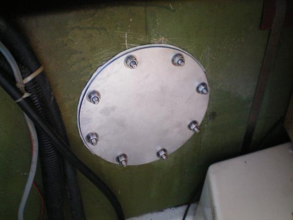

We still have the original tank too. So far so good.
I think you would see signs if leaking.
About that fuel boost pump - you would never think a leak would get to the bilge, but it does. I found diesel in the bilge in Panama City (Florida) during our cruise from Texas. Once I finally located the leak and replaced the pump, no more diesel in the bilge. I still don't see how it gets in there.
She's a great old boat. After 2 years of cruising and 5000 miles, the leaking fuel boost pump has been our only repair.
Before we left our home port, I had an access panel installed.
The tank was cleaned and inspected, and filled the tank with 30 gallons of clean, fresh diesel. The guy I had do the work pointed out where the low spot was (indicated by some pitting) inside the tank, and says that is where the tank will eventually give out.
Good luck finding the leak.
