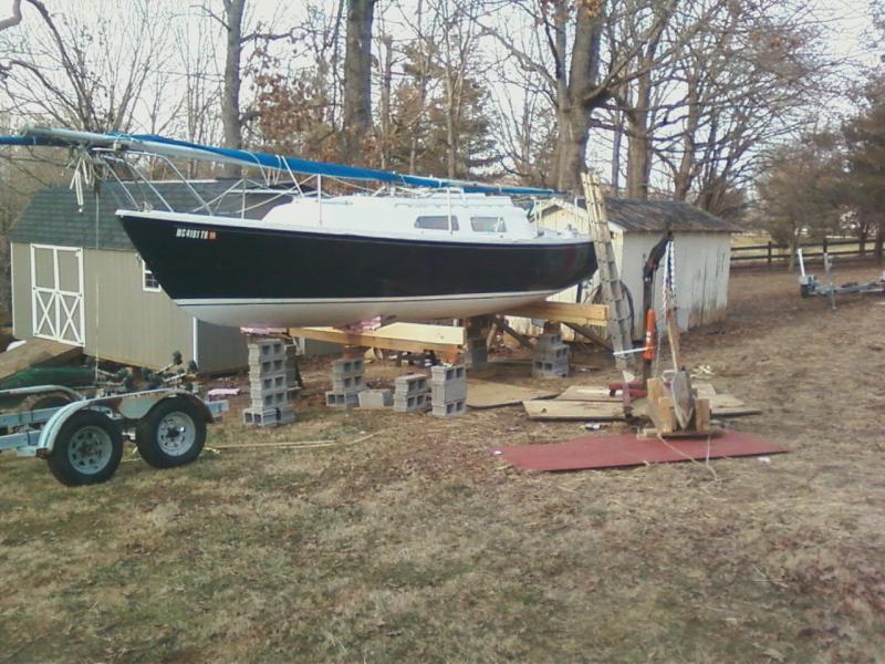

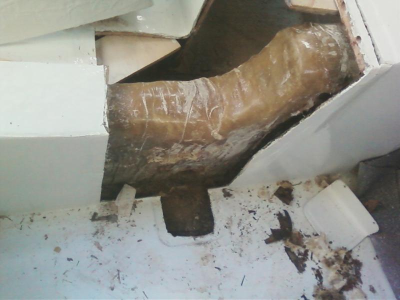

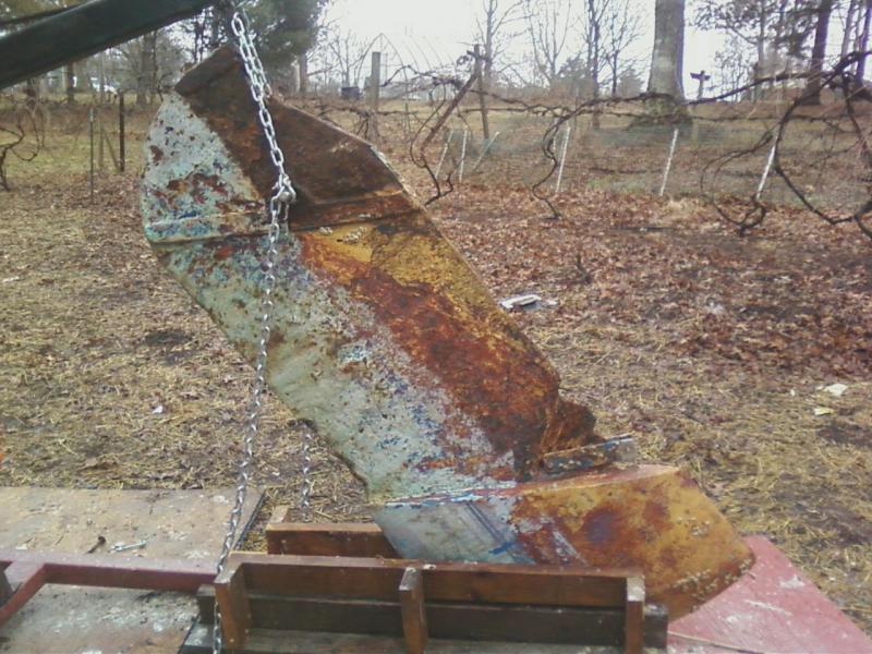

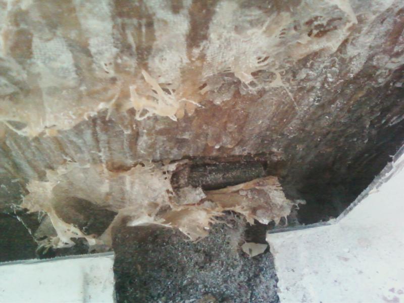

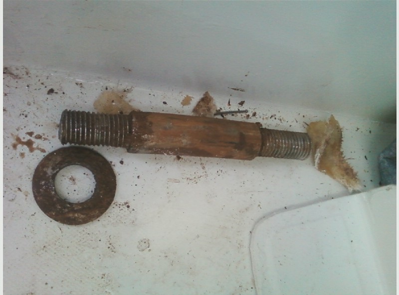

I have a Balboa 26. I bought it last Spring. And like you the keel bolt was glassed over. It was a huge job to lift the boat onto a cradle, drop the 1200# keel. The 7/8" ss bolt was bent as was the bushing. So I'm very glad I replaced mine.
I dropped my keel because I also needed to do some repairs to the keel itself. You might be able to just jack it to take the pressure off of the bolt and then slide it out for inspection. If it is bent, I'd replace it... and a new bolt is only $20 so just go ahead and replace it for peace of mind.
I have an entire folder full of the pics I took during the process and would be happy to send them to you if you think it would be helpful.

Here are some pics. I have a lot more if you want to see something specific let me know and I can send them off list.

rgranger the pics are great! I would be particularly interested in any that you have of your "cradle" and of putting the boat on the cradle. I have a basic idea but looking at other peoples setups always helps!!
