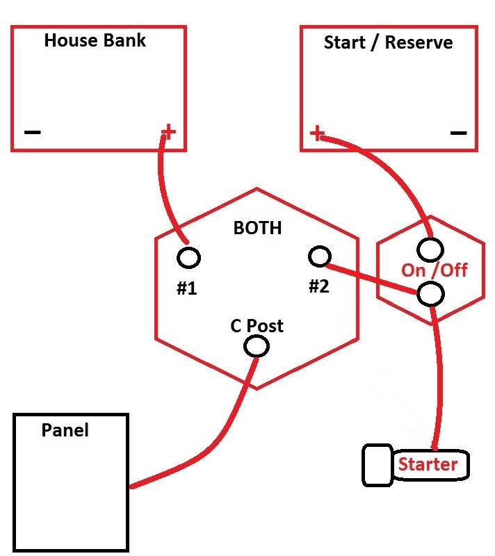

How many 1/0 lugs will fit easily on the starter? My wiring plan uses a separate battery for the starter, but involves a wire from the disconnect switch, as well as the 1/2/Both switch on the starter. I'm using heavy duty power lugs, which take up a lot of space. Hopefully I can get two on the starter stud easily.

I don't think you want to do it that way. There should only be one lug on the starter. The one wire goes to one disconnect terminal to which is also connected the "2" on the 1/2/Both switch; the other terminal is connected to the engine starting battery.
There are a couple of threads on this topic.
Please excuse if I misinterpreted what you want.
To answer the question, I think the issue is not so much the thickness of the lugs, but the "stacking" of the terminal barrels which connect to the wire. You usually have to fan them out, or reverse one, and quickly run out of room.

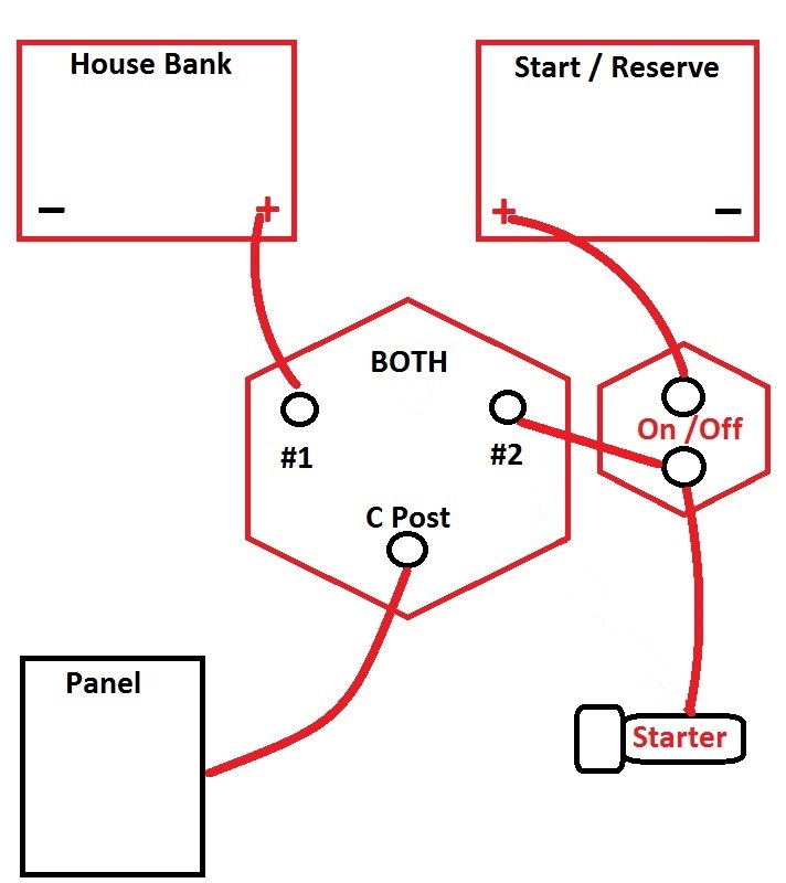

I see the image you provided. I was trying to understand the wire from the #2 on the switch to the Starter.
Here is a diagram from the MaineSail writeup. The wire in question goes to the switch not the starter. Only one wire goes to the starter. The switch has enough space for two lugs. The starter motor stud usefully only has space for 1 lug. Electrically they look the same but the MaineSail diagram would be safer. One wire to disconnect when servicing the starter.

The issue I saw with doing that is the starter is between the disconnect switch and the 1/2/Both. So going from #2 to the disconnect is a longer run. But I see the good reasons for doing it that way and will modify the plan.
Thanks!

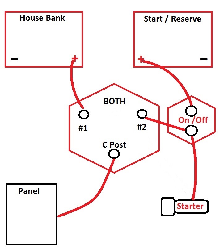

Revised diagram. Starter lug problem solved. This forum is a great resource.
You could also install a Blue Sea Power Post near the starter so only 1 wire run up to starter stud...

Thanks, that's a good option. You know how crowded that area is on the C310. Do you think there's a good spot for it? Or it could go on the opposite side of the bulkhead behind the engine; the wires run through there anyway.
