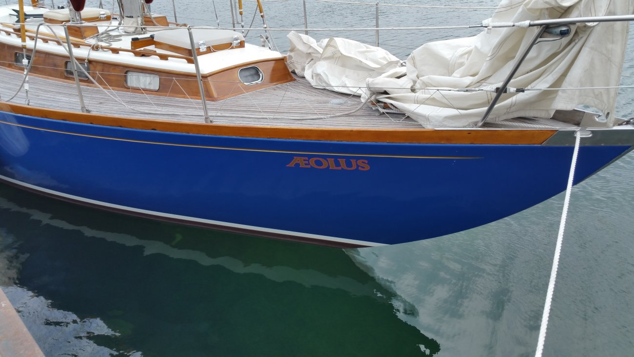

here comes season 48 with aeolus in the family.
