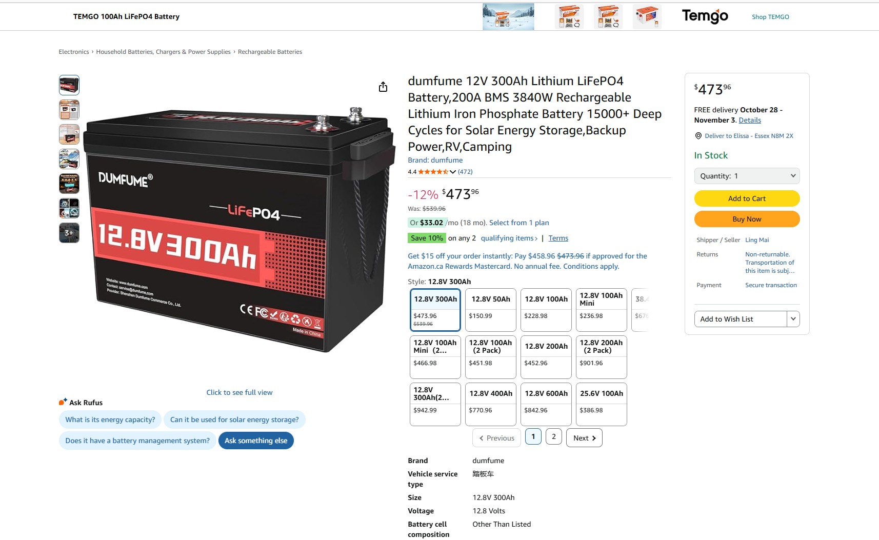

For example here is a listing on Amazon.ca at a "good price"....good battery??
Not a particularly high quality battery, but it is hard to tell. Unless you run a capacity test on them, and cut them open, it is hard to tell what you will find inside. Typically, reputable name-brand batteries will cost more than chinese knock-offs with unknown cells.
But some manufacturers do a nice job, with quality cells.
i have been watching this guy for a while now, as he cuts the batteries open and inspects the cells, BMsS, build quality, etc.
Part of the problem is that who knows if some of these cheap batteries (or maybe even the more expensive ones) use the same cells, etc. over time.
