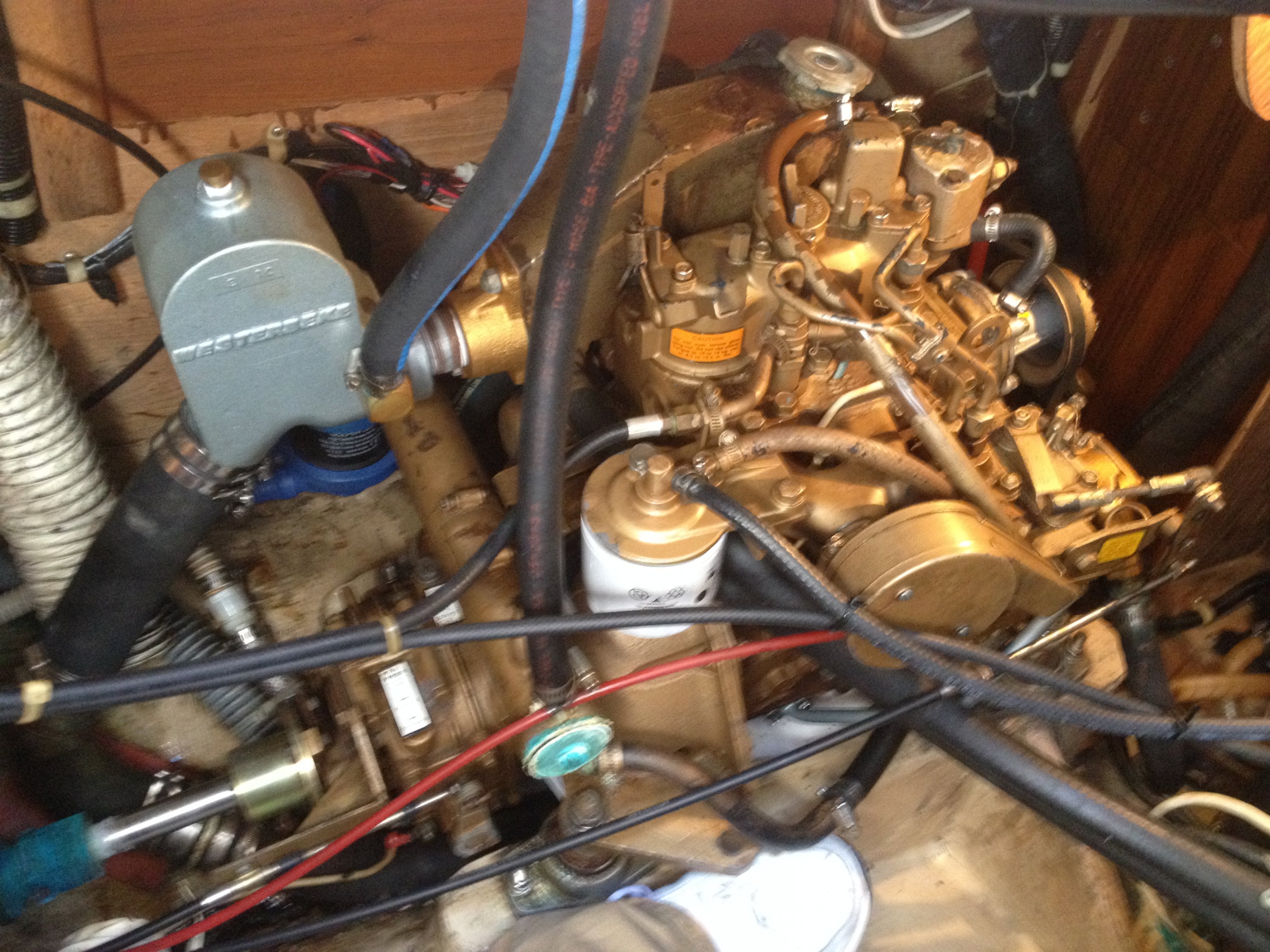

Mine in 6 years old. About 300 hours. Looks new (pic).
....on the outside.

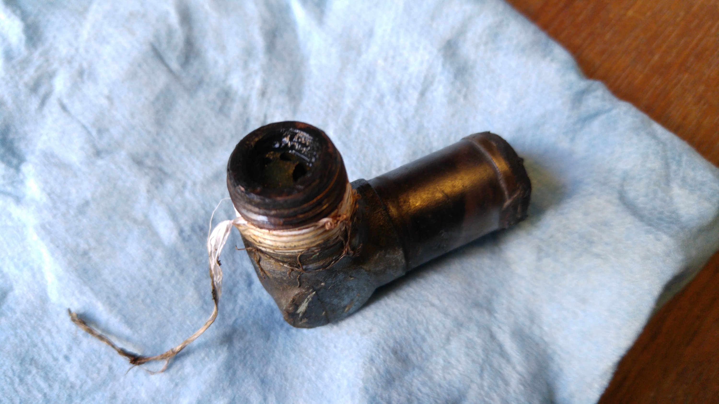

I have to clean mine every season just so it won't clog up. See photo.

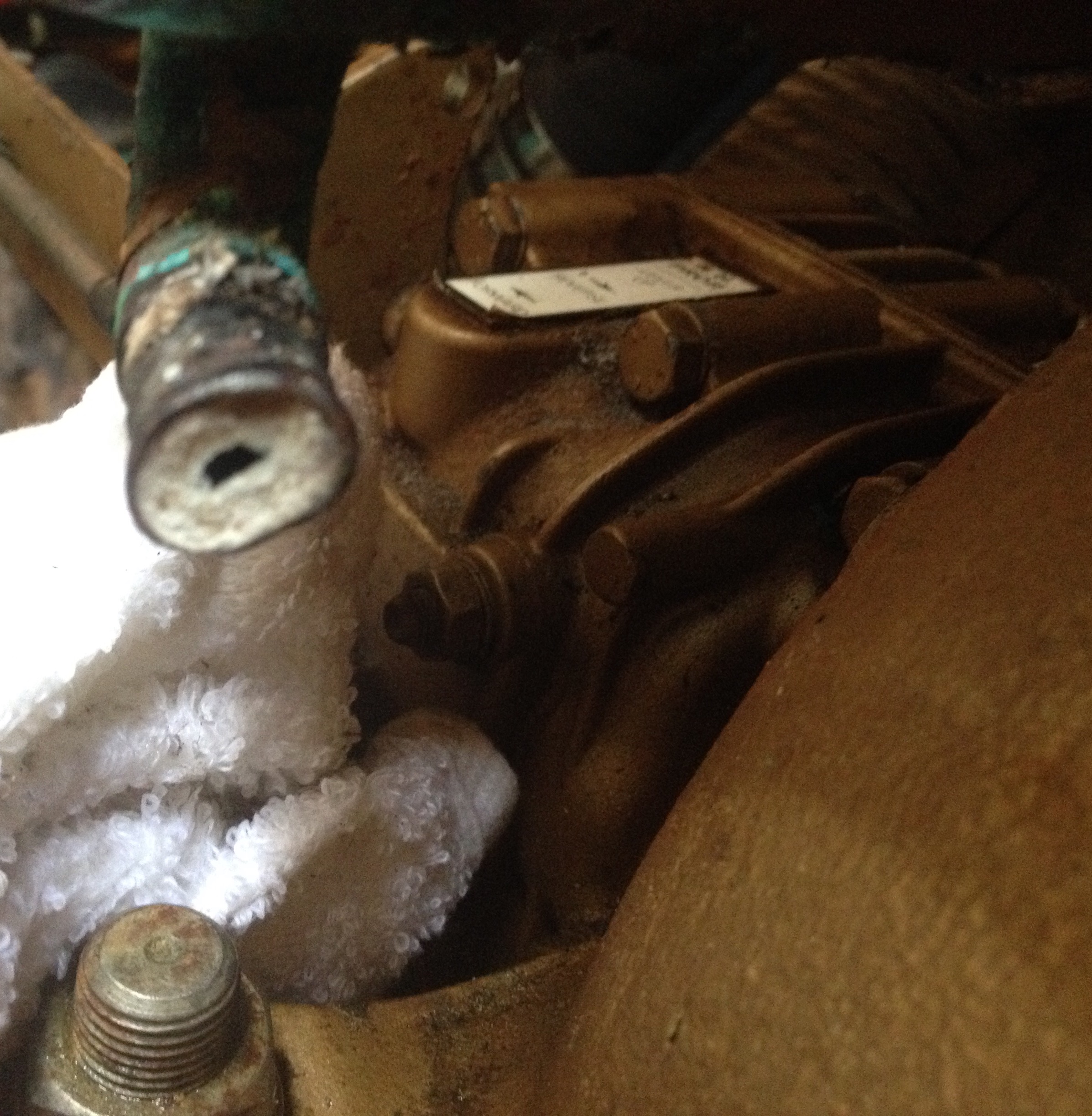

I decide to check the pump output just in case. Remove the HX raw inlet hose at the bottom of the HX, and see this:
The odd thing is that the rods are clear inside.

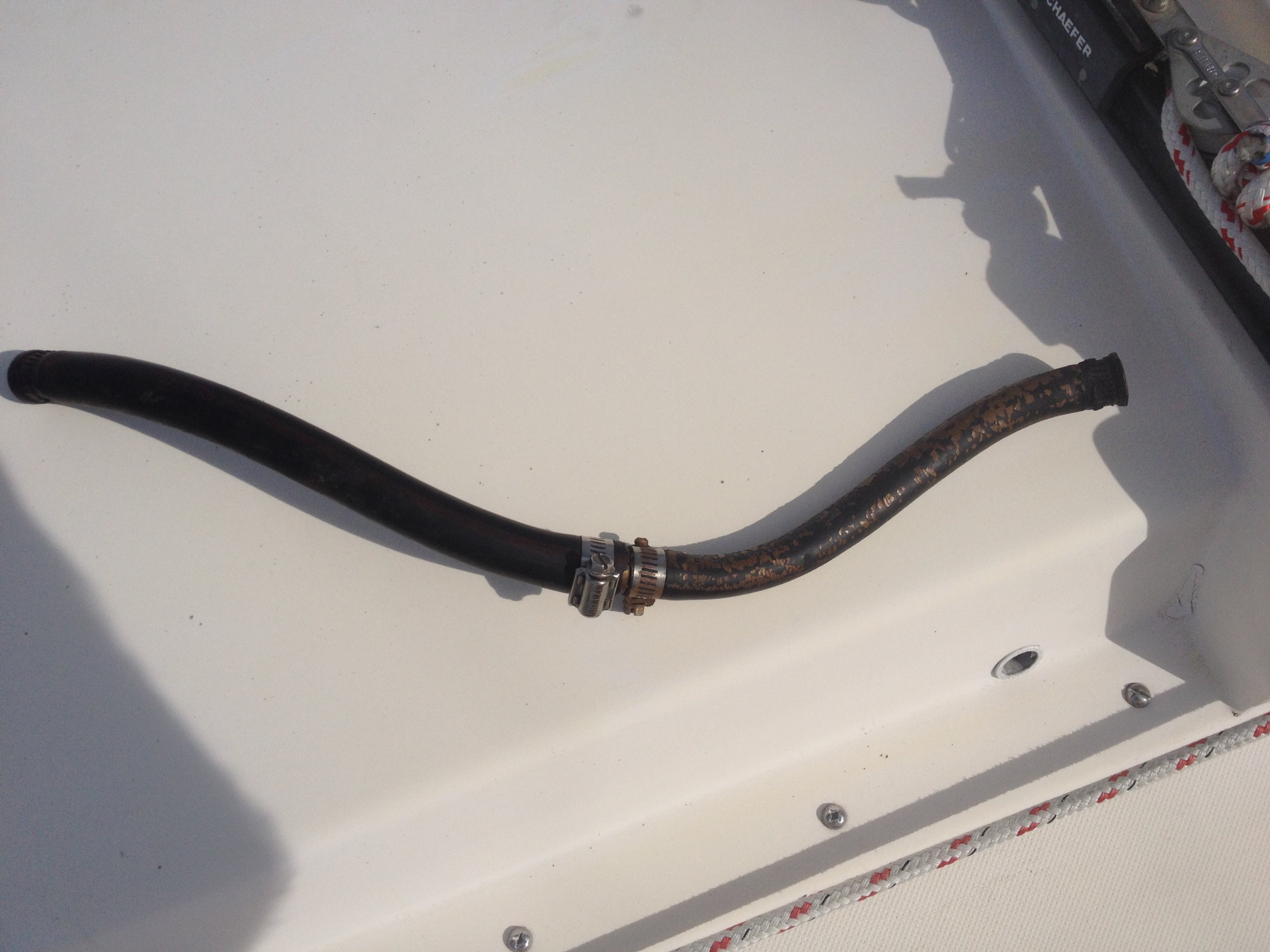

Turned out only that HX inlet elbow was clogged. Minor calcification elsewhere. Cleared it out. Also replaced the hose from pump to HX; it was too small a diameter and a hodgepodge of 2 lengths of hose (pic). Probably from when the yard monkeys installed the new Oberdorfer pump 6 years ago. - I should have done it myself.
I think the raw water filter I installed 2 years ago restricted the flow, causing calcification to build up.
It never caught anything other than little plant bits, and the motor ran without it for 32 years previous. So I removed it.
Rapid flow now. Didn't have to replace HX nor mixing elbow.
Total repair cost: $8. (Hose)

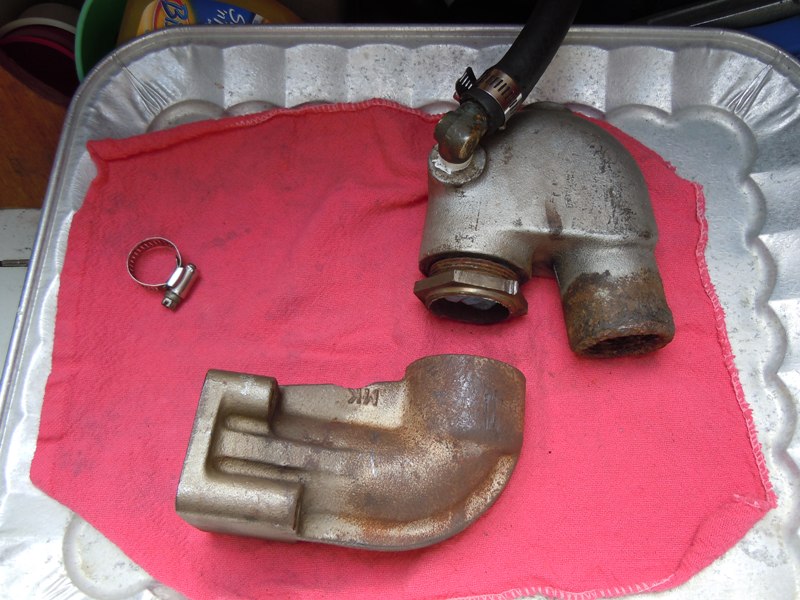

The OEM mixing elbow on my 1986 Yanmar 2GM20f lasted about 25 years...and it was nice enough to give plenty of early warning (reduced max rpms) that it required attention.
1,715
Hunter 34 Alameda CA
Yes, mine lasted 25 years as well. But it wasn't as kind to me when it broke in half. Other than the annual cleaning of the water inlet fitting, I only cleaned the rest of it a couple of times during that period. I am going to change that little fitting to a straight one and am looking forward to trying the spring that Rick D has posted about for annual cleaning. The close nipple with both left and right hand threading is a real weak point. It's made of stainless and can only be inspected easily by complete disassembly. I have located a reference to a black iron or galvanized right hand/left hand 1-1/2" NPT threaded hexagonal nipple here:
