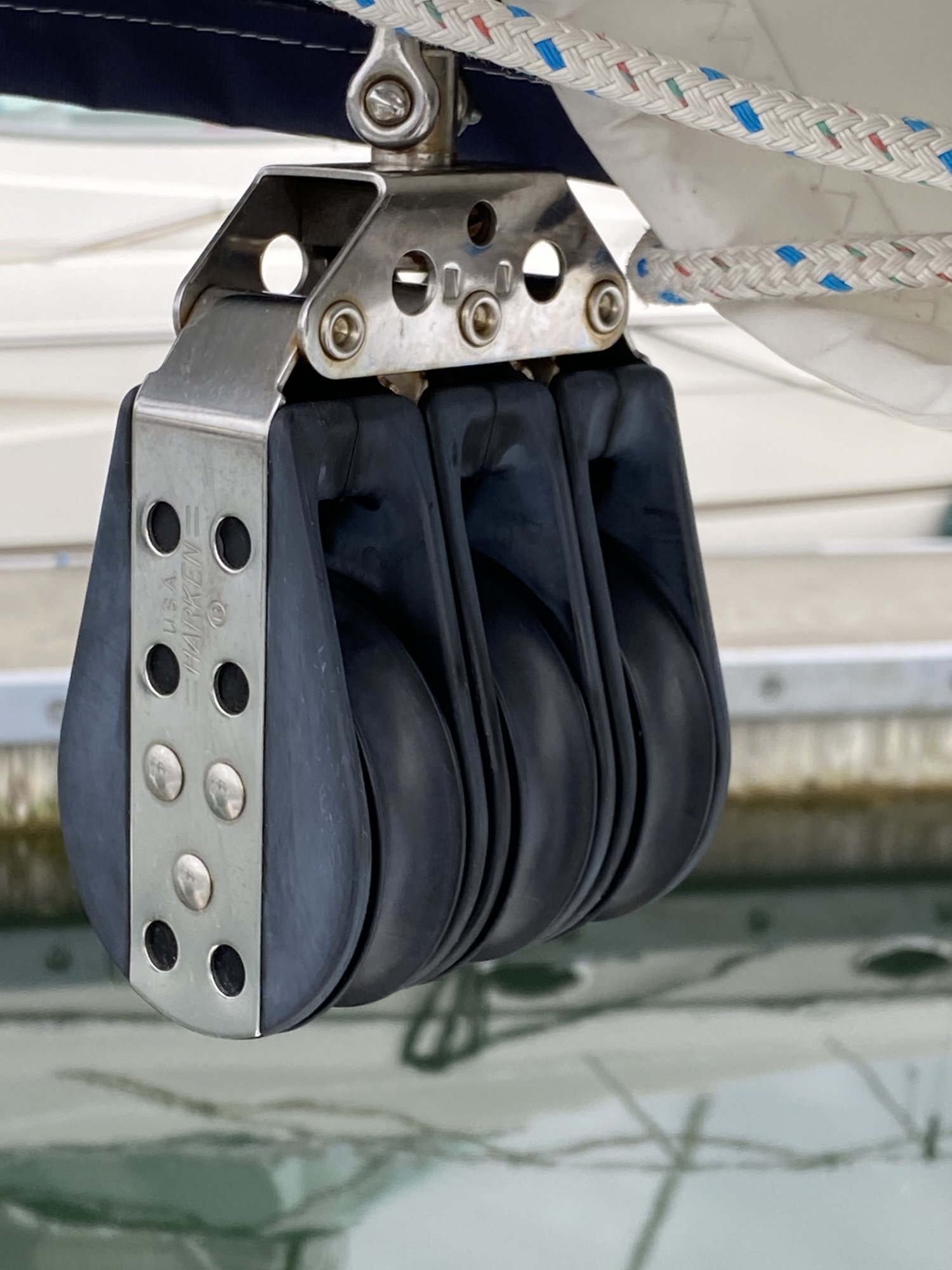

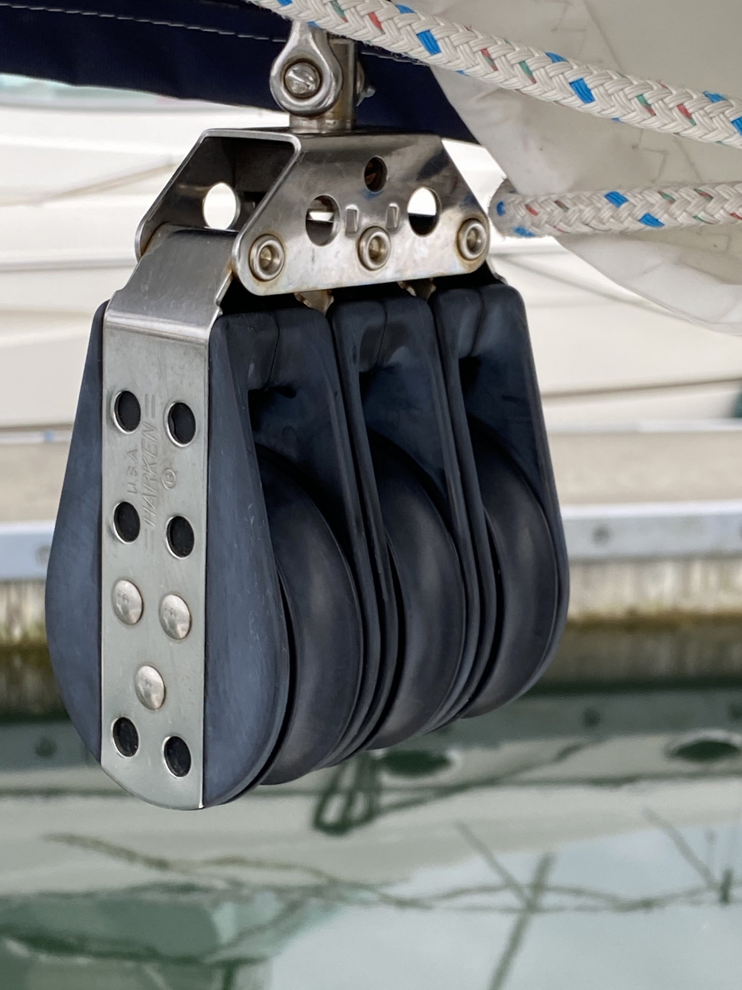

I am talking about the sail boat hardware that nobody talks about.
The blocks and tackle that sit out on the deck or hang from the boom, rain and shine sucking up dust, dirt, salt spray. We expect the hardware to be tough and always ready when we want it to perform.
Well Blocks and tackle need a little loving too. Not much is needed. Like the drum on a furler, give the block a good flush with fresh water a couple times a year.
You feeling especially nice, fill a bucket with a little dish soap and water. Dip the block in the bucket a few times, swish it around, Watch the dirt and grime fall into the bucket. Pull it out and flush it with fresh water.
Your block will reward you with another several years of faithful service. It will actually work better and make it easier to haul in that sail faster, easier, tighter.
Blocks need loving too.

They certainly do. The Garhauer blocks in my mainsheet (2004 vintage) just recently lost all of those little bearings. Little black shavings all over the deck. Needless to say the mainsheet wasn't as useful after that.
Ponied up some $ to Garhauer for new ones and all is well. Had em in a week. Mostly match the other blocks but the stainless bits are are nicely shiney.
Always wash all the blocks when we wash the boat - every 2 wks or so.
