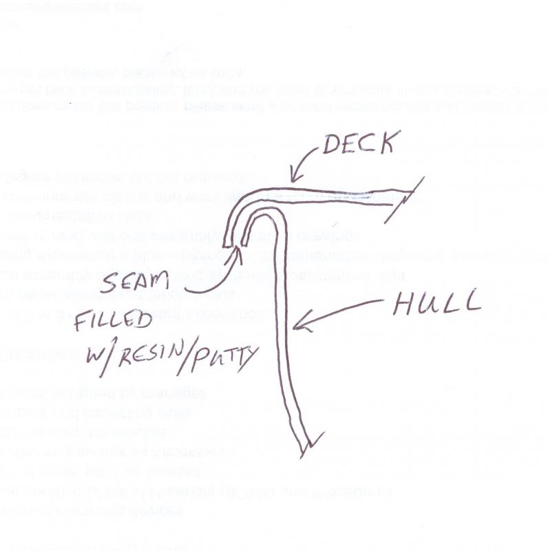

I know that I looked at an older (1973-5?) DS II at D&R that had an added rubrail and it had been attached with sheet-metal screws as best I could tell, although the screws were short enough to just barely stick through the underside of the hull-deck joint. For any non-DS II owners, the hull-deck joint on the DS II is sort-of an outward turned flange that curves over like a plastic bucket rim, the deck edge is bonded over that like the lid of a trash can. See drawing below, I am reasonably sure the CCSB Day Sailers are similar, although the joint is squared off, not rounded.

Thanks for the drawing Sunbird, yes the construction of mine is very similar
