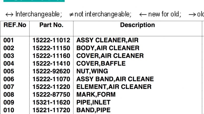

Thanks again for this thread. Any chance you can post a higher res image of the exploded diagram from the first post?

Aaron, Thanks again for this thread. Any chance you can post a higher res image of the exploded diagram from the first post? Thanks, Jim

I have uploaded two pictures for you. One is for the L245 tractor which is what I used, the other is from the D950 manual. If I had to do it again I would probably consider the D950 parts. I have no good reason for that, but looking at the parts I feel that the bracket available may be easier to work with and with the second silencer may be even quieter. Again, I can't confirm this.
Just in case the pictures I have used are not legible I will give the part #'s I did use and would use for both set ups...
L245
15222-11012 Compete air cleaner assy.
15321-11620 Itake air pipe/hose
15221-11720 x2 Clamps
D950
15372-11010 Air cleaner assy.
15371-11250 Air cleaner band clamp
66711-54310 Air cleaner mount bracket
01123-50829x2 bolts for bracket to air cleaner
If using the D950 air cleaner I would still use the intake air hose from the L245. It is much longer and allows for better positioning out of the way. With my setup I also put a hose barb fitting in the intake to run the crankcase vent hose on the top of the valve cover into the intake. This is the way automobiles are run. Tractors are not. It does a great job getting rid of that awful smell especially after running...
