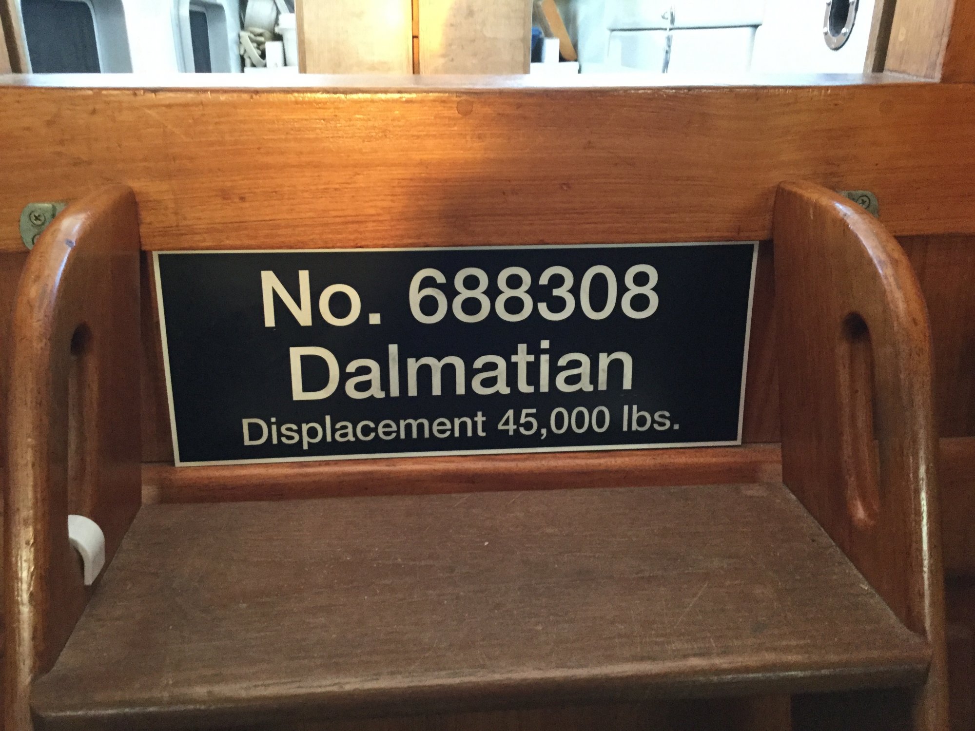

Hi Tom, looks photo shopped to me. Can't imagine a boat weighing that much. Must be a misprint on the sign.:p
I already had my coffee so here goes. If I start adding weight to get near the displacement volume, lets say 40,000 lbs, would that be when my toe rail is just above the surface?

If the design says 45k and I add 40k, the boat should still float? Submarines have this figured out because they use it to travel. I might be getting rid of a 1000 lb generator so the water line would change, just thinking about how much.
