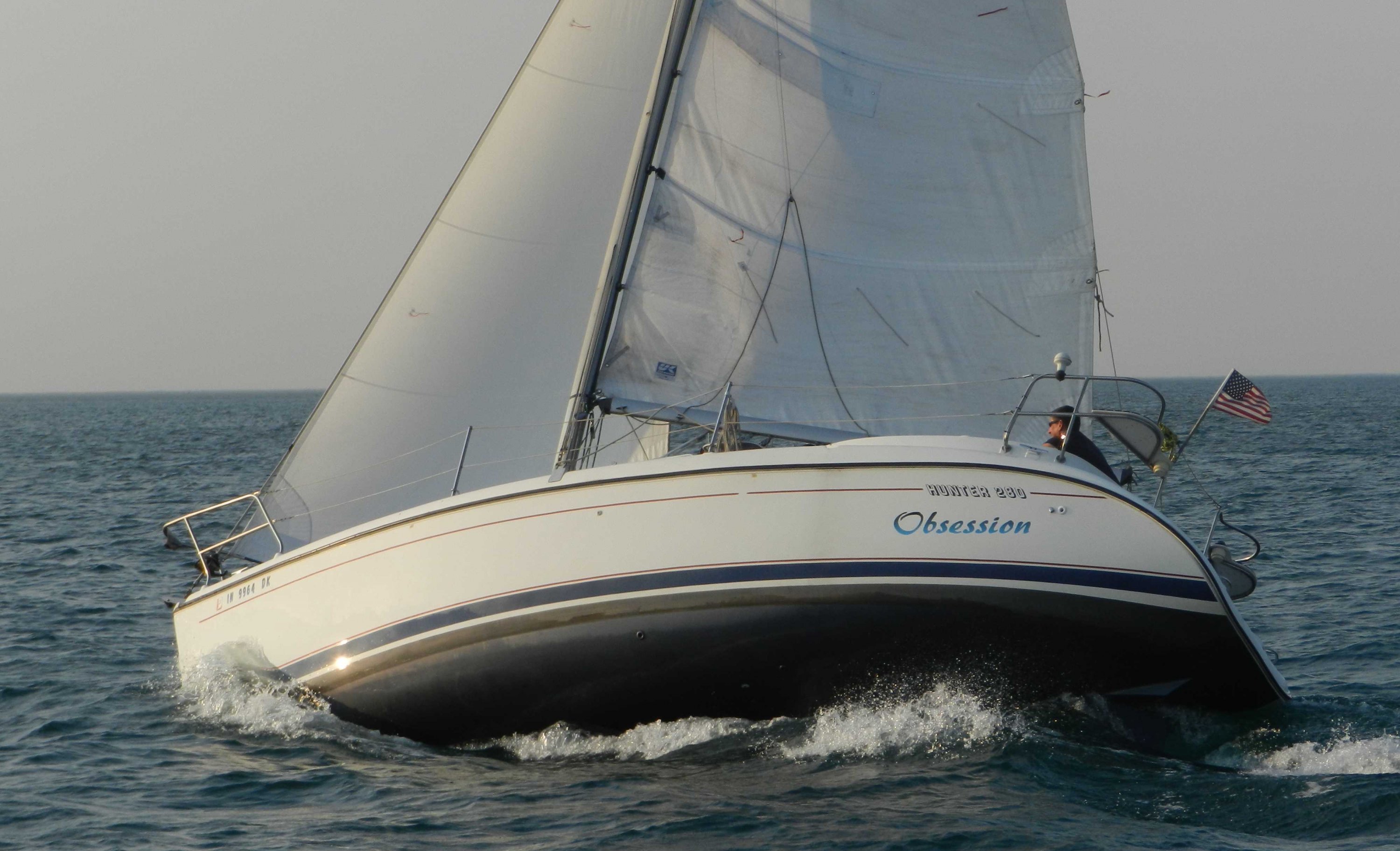

Patience Grasshopper....it takes some practice to maximize your speed! I had a Hunter280, so a bit bigger boat, but I had a hard time making over 6 knots when I first got her. But I got better and eventually could get her over the hull speed in ideal conditions (like the picture below). image.jpeg
A lot depends on the wind, your angle of attack, sail,trim, etc.
I had an inboard diesel, so cannot comment on the motor speed.
Just have fun practicing, and I am sure the speed will get better.
