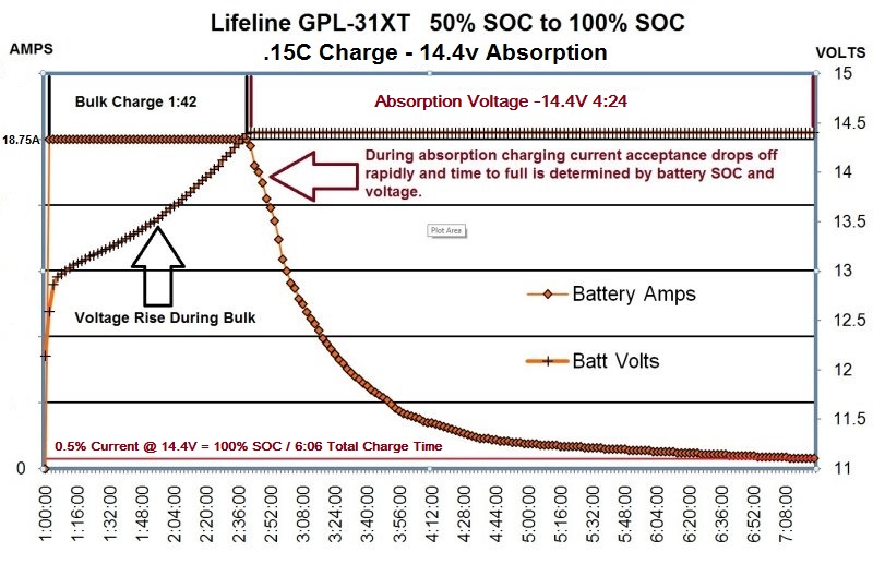

This chart clearly shows the differences between Bulk/CC and Absorption/CV
BULK: If we start at the top left of the chart we can see that the current held rock steady at 18.75A for 1:42 minutes. This current, 18.75A, is .15C or a 15% charging current of a 125Ah battery.
VOLTAGE RISE DURING BULK: If we look at the left side of the chart we can see the voltage climbing towards the absorption set point of 14.4V. It took 1:42 minutes at a rock steady bulk/CC of 18.75A for the battery voltage to reach 14.4V.
1/3 From Left: This is the point where constant current/bulk and constant voltage/absorption flip-flop. Voltage stops climbing and is held steady, and current changes from being steady/constant to declining. Once the BULK/constant current charge has driven the battery voltage to the absorption voltage limit, the voltage is now limited or held steady and the charging current begins to decline.
CHARGE TIME:
As current declines while the voltage is held steady, and the SOC rises, out towards the lower right of the chart, the time it takes to get that last few % in takes significant time. At .15C this battery took slightly over 7 hours to reach 100% SOC.
As can very clearly be seen here bulk is constant current UNTIL the voltage has risen to the absorption point where it is then held steady and current declines..

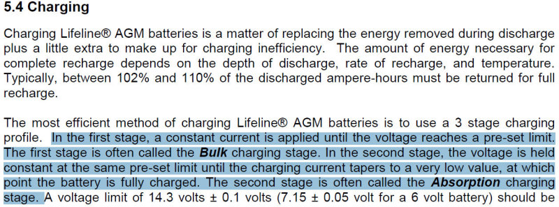

"In the first stage, a constant current is applied UNTIL the voltage REACHES a PRE-SET LIMIT."
So to illustrate - take the case of a programable source - perhaps a programable voltage regulator or programable shore power charger. If bv (bulk voltage) is set to 14.7 and if Av (absorption voltage) is set to 14.5 which of these two values is the 'pre-set limit'?
If the controlling pre-set limit is the Av value then why not set the bv value to that same number? For that matter why provide any ability to make these two values different?

Lifeline technical manual http://www.lifelinebatteries.com/manual.pdf page 19 has the info
They seem to imply that you can see the CC level very high indeed with the lifeline battery. Maine's data would indicate that higher CC would result in exiting bulk charge even sooner he has 0.4C exiting bulk in 20min vs over an hour for 0.2C. If you cranked it to 1C you would be out of bulk maybe almost instantly, but until your charge current had fallen to 0.4C you would be "ahead" in restoring capacity. Well as an aside, I think my 8A charger is inadequate considering my 200Ar bank. Although my typical scenario is 10% discharge during a day sail followed by 1/2 of motoring at 50+A of charge followed by 8A off the shore charger maybe not too bad.

This was Maine's first battery instructions when he invented the battery.
Nice that you kept your copy Brian.
