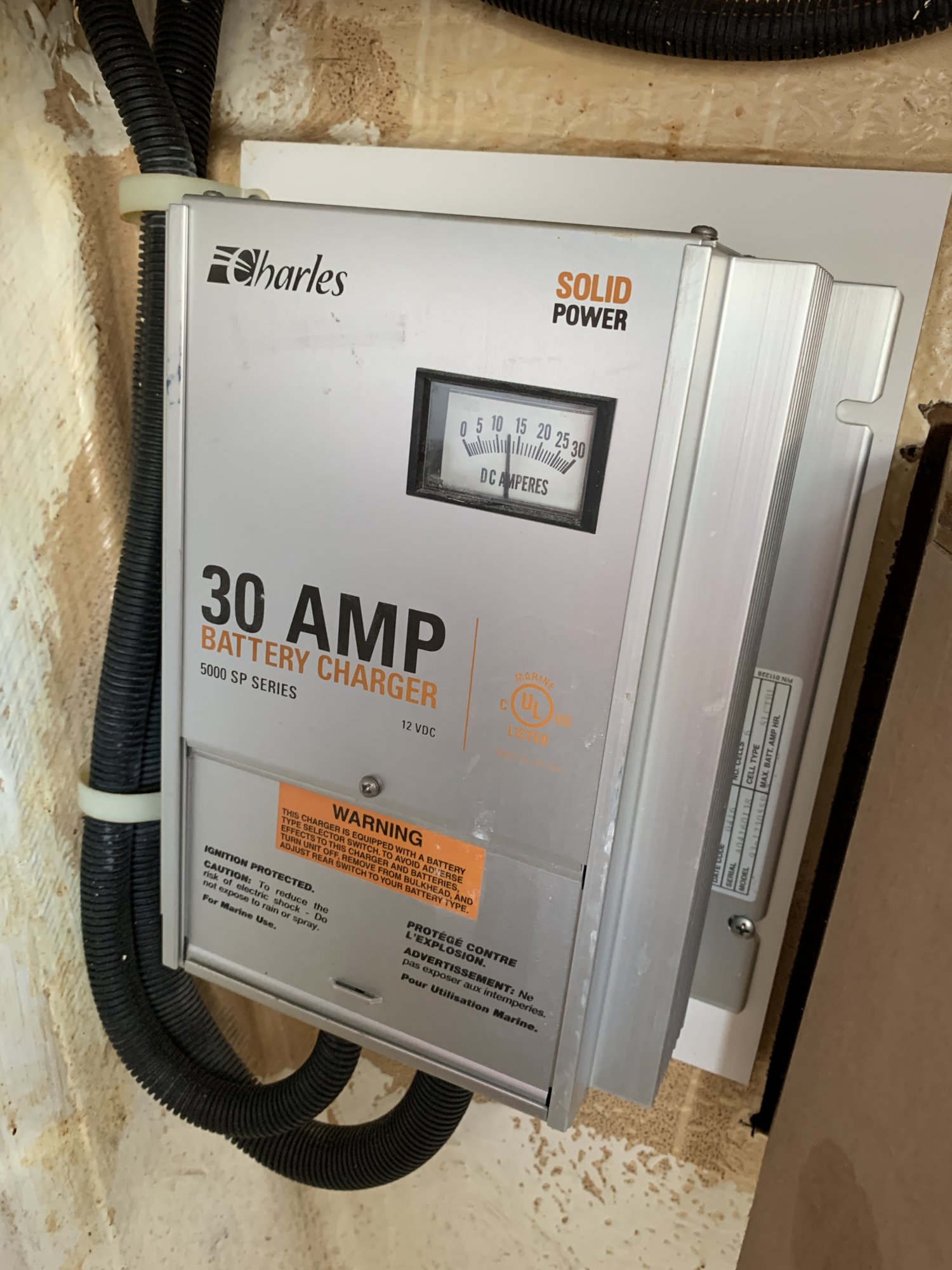

Remind me which battery charger you have. If I recall correctly in another thread you showed a photo of a Charles Battery charger. Those chargers have a fixed bulk charge time of 4 hours, whether the battery needs it or not. As a result the batteries are over charged which is just as bad as undercharging them.
The fixed bulk time chargers are OK for batteries that are routinely deeply discharged as you might find on golf cart or electric pallet mover. For a boat where the discharges are shallower, they are deadly (to the battery).

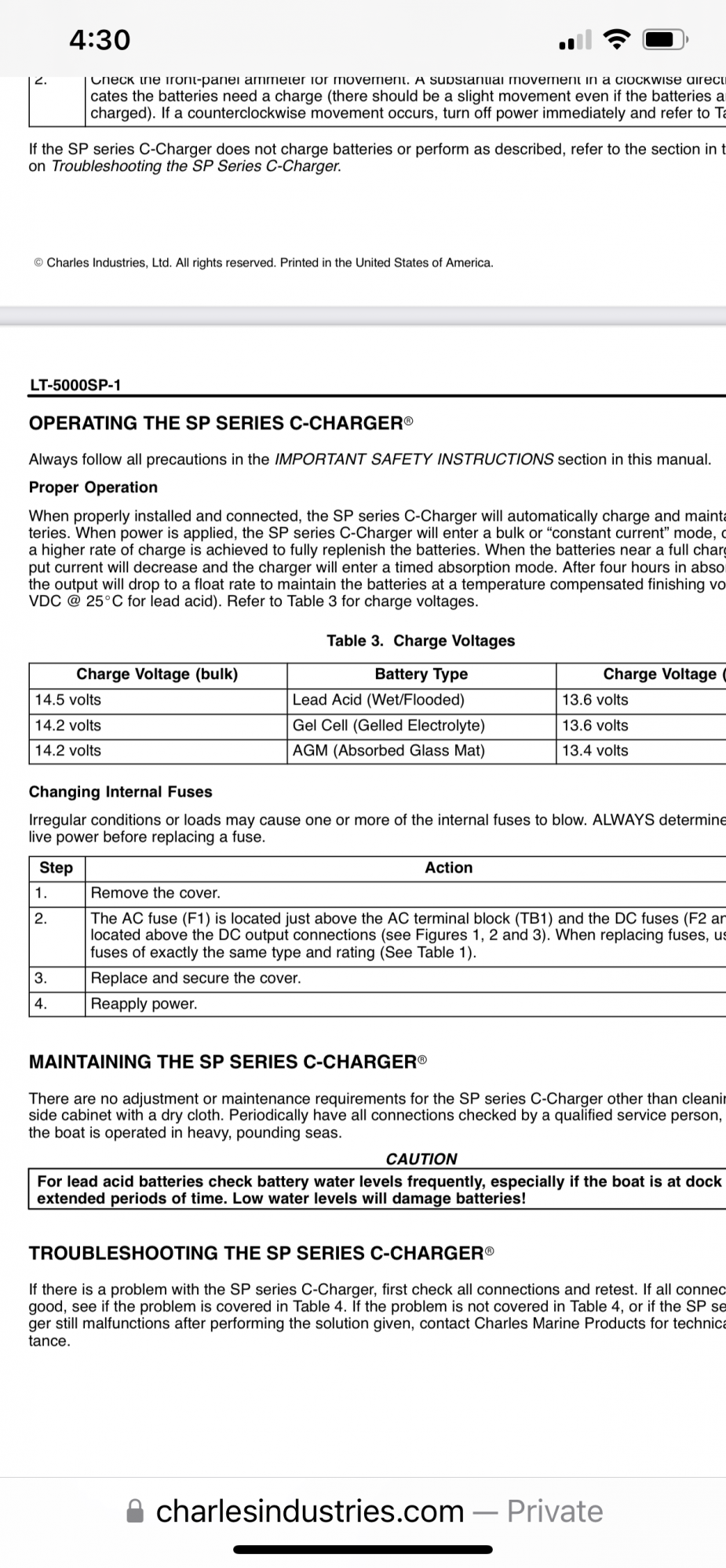

From the Manual, page 12:
Proper Operation
When properly installed and connected, the SP series C-Charger will automatically charge and maintain the bat- teries. When power is applied, the SP series C-Charger will enter a bulk or “constant current” mode, during which a higher rate of charge is achieved to fully replenish the batteries. When the batteries near a full charge, the out- put current will decrease and the charger will enter a timed absorption mode. After four hours in absorption mode, the output will drop to a float rate to maintain the batteries at a temperature compensated finishing voltage (13.6 VDC @ 25_C for lead acid). Refer to Table 3 for charge voltages.
After pasting the above, I see you also read the manual. The problem is the time based absorption phase (I did not correctly recall the information earlier when I said Bulk phase). The charger will keep the voltage high even when the battery does not need a higher voltage. This is damaging to the battery and causes the off gassing that was discussed in another thread.
Again, this method of charging, with the timed absorption stage, is not bad if the battery is deeply discharged down to 50-60% because it will take 5 to 6 hours to fully charge from that level. Except, if the battery is not ready to go into the float stage, it will not receive the voltage it needs. This is damaging to the battery. This was a good attempt to optimize charging 30 years ago, we're way past that now in understanding batteries and charging protocols.
Good modern 3-stage battery chargers change stages based on the battery's ability to accept a charge. Briefly and simply, a modern charger will start with a high current charge at a low voltage. As the battery is charged the voltage will rise and at a predetermined voltage level the charger will maintain that voltage level as the current (amps) gradually decreases until is it only able to supply a small amount of current, when it will shift to a low current low voltage float level. If the battery is deeply discharged, the charger will take 5+ hours to go through those stages, if the battery is not deeply discharged the charger will only take a few minutes to a few (less than 5) hours to cycle through the stages. And that's the problem, with a timed charger, like the Charles 5000 series, there is too much time where the charger's output is out of sync with the battery's need. That causes the battery to seldom be charged at the correct stage and to often be charged at the incorrect stage.
The other and less critical problem with the Charles charger is the fixed settings. AGMs, Gels, and FLA batteries from different manufacturers have different "ideal" charging voltages. Some AGM manufacturers may want a 14.6v absorption, some may want a 14.2v absorption voltage. The charger can't be fined tuned to the manufacturer's recommendation, the Charles uses a best guess voltage.

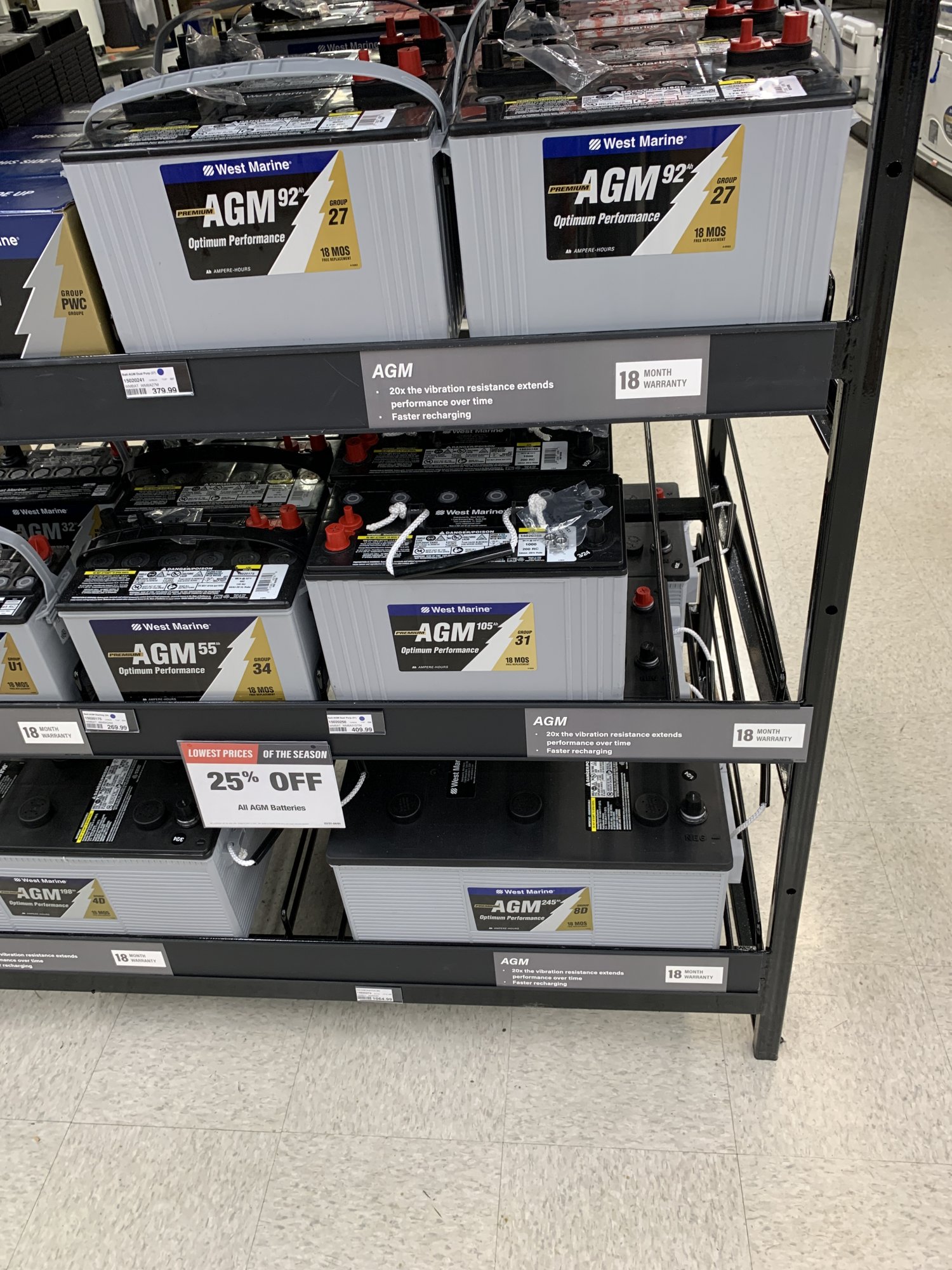

this is the one I am looking at. It is the group 31 on sale for $300
13,961
Those are the ones you don't want to buy.
Don't take my word, take it from the real expert.
Never buy batteries from West Marine. They are made by East Penn and the identical batteries can be purchased at Sam’s Club, NAPA, Batteries Plus and dozens of other retailers for significantly less money. Many WalMart locations also have the East Penn product. I will never advise the East Penn AGM’s as they are not a deep cycle product. Their GEL batts are amazing but you need the charging infrastructure correct or you’ll ruin them…
