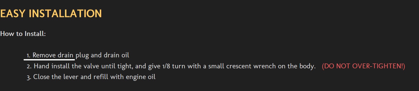

Our solution was to stop doing that any more by buying one of these Easy Drain Valves
Really thought my life was about to change ...................... until I read the installation instructions.
I think most marine engines avoid drain plugs to stop people from draining the crankcase oil into the bilge and from there into the environment.

capta
Jun 4, 2009
4,952
Live in hope, die in despair.
What engine do you have? Is it possible there is a drain, usually in the back end of the pan, and you haven't located it. We had our engine for 9 years and never noticed the drain plug.
