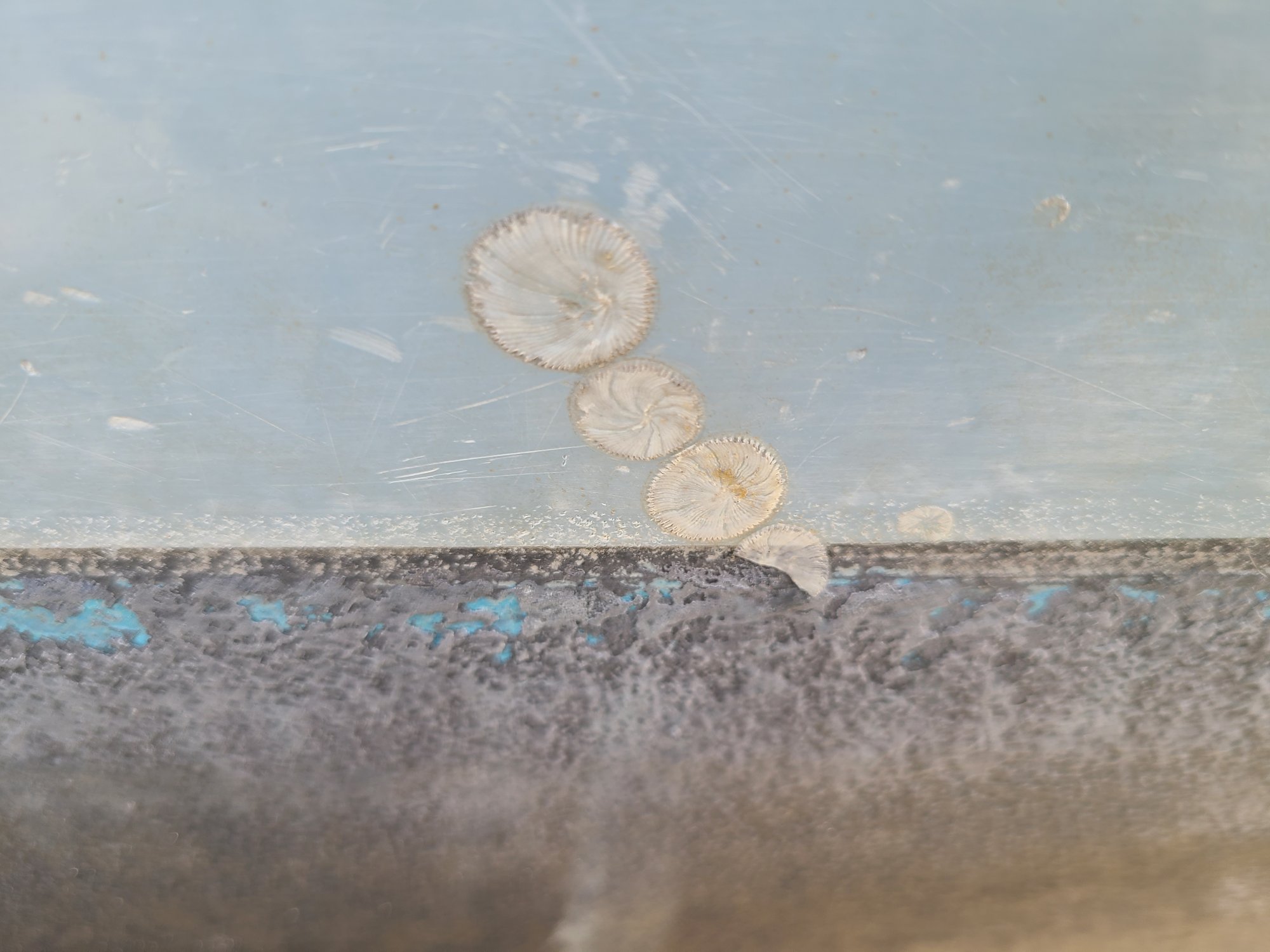

how do you remove minor barnicals on gel coat
Dil
Jul 13, 2020
58
Hunter 30T Neptune
how do you remove barnicals from gel coat I don't have very many

Painter's 5-in-one tool should do the trick if you're not too aggressive in scraping.
May 12, 2004
1,505
Those look like they are above the waterline. (?). Also look like something other than barnicals. Scrape them off using a plastic scraper so as not to scratch the gel-coat. That's all I got at the moment.
