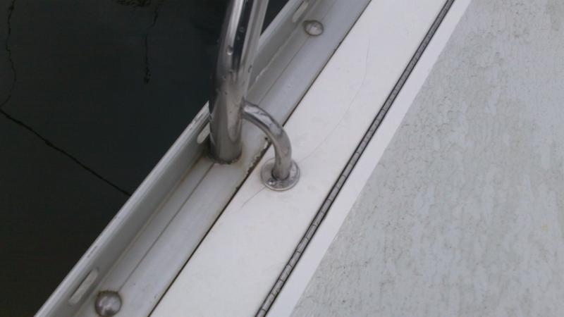

OK, so in the first photo is an image of the underside running lights wire feed into the bow pulpit. I cannot get a hand in there. the good news is that it looks like a tube runs through the deck so the wire should not be stuck with 5200.

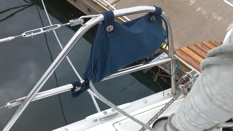

The second photo shows the small wire tube going from below deck to the pulpit. The third shot shows the layout of the pulpit and the fourth shows how the wire exits the pulpit for the running lights.
So it seems to me that to replace the (non-marine grade) wire in the pulpit, I first have to remove all the bolts from the pulpit and then gain access to that feeder tube. This is where I get lost.There MUST be a trick to pulling wire through a pulpit. I can use the old wire, but given its delicate condition, I don't trust it very much. So, I could use a wire puller, but the end is too large, so I would have to cut it off. But, even if I do that, how the heck do I get it out of the small exit hole?? Magnet?
Some folks must do this all the time. Looking for suggestions!
