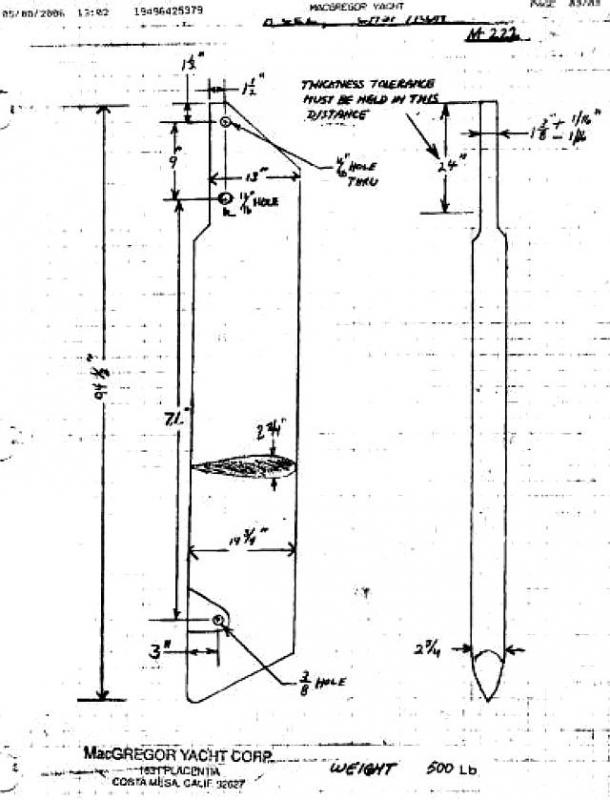

Search this forum for "keel dimensions" or "keel drawing." I know that someone has posted a Macgregor drawing for the original build of the V222 keel, measurements and all.

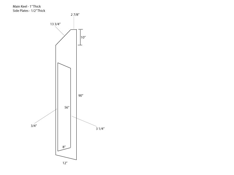

Perfect, thanks. I attached a drawing of the current measurements without any filler or glass on it. Looks like there is quite a bit of material missing just by the measurements.
