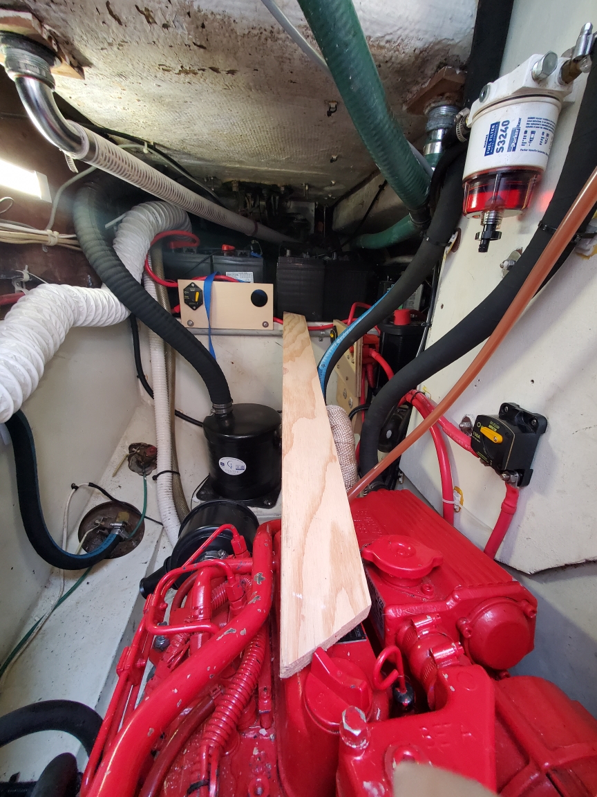

The other day, my friend with the slip next to me came wandering down the dock with 2 new batteries in his cart. “Hey John can you give me a hand?” Sure… What do you need? “I need to install these two batteries and I can’t lift them into the boat.” That sounded like a simple assist. They were each about 60 pounds. Up onto the deck and then down through the companion way we went.
It was then that he shared the real trouble. His on board storage was on a shelf behind his new engine. I climbed into the limited space to the side of the engine and quickly decided there was no way I could grab the battery, hold it out at arms length and rotate my body to slide it on to the shelf.
He said he got the old ones out. Perhaps that is why he was recovering from a hernia operation.
Stuck we regrouped. It was then I remembered an article by @JamesG161 and his ramp to move his generator out of his boat.
My neighbor went home and grabbed a board. I headed back to my boat. The next day I got this message.
Genius.
You never know where an idea may come from to solve your boat problem.

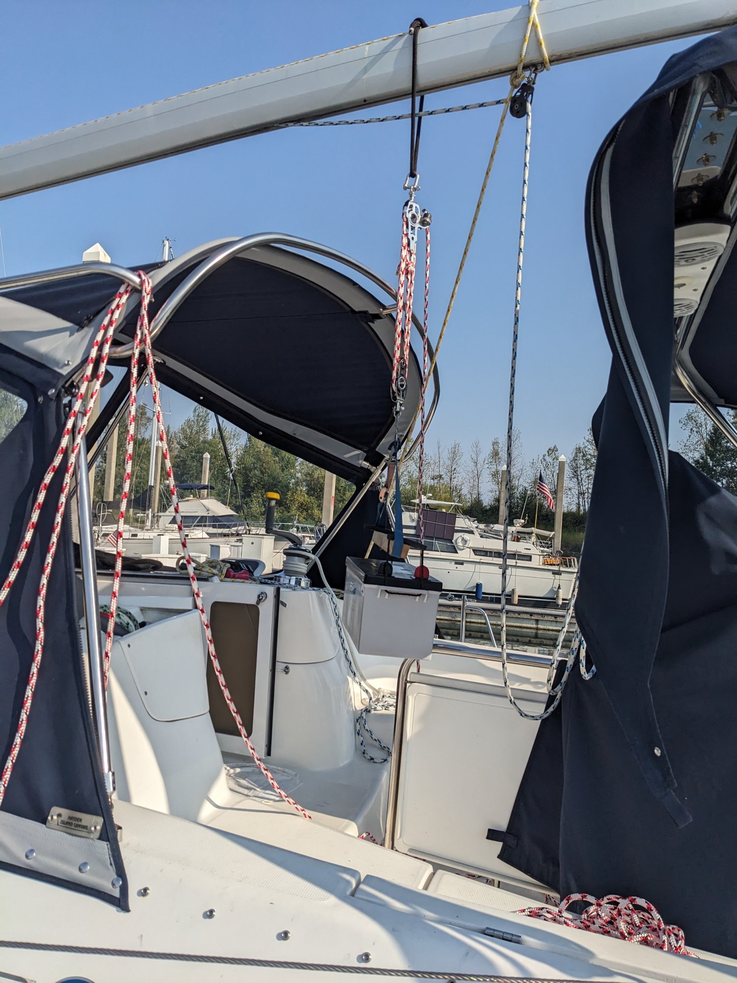

Yesterday and the day before I swapped out my four 6V flooded cell deep-cycles for new ones. I hung a 4x block&fall from the main halyard. When I lifted the new ones from the dock, the battery would naturally swing toward the centerline of the boat. I lowered through the deck hatch down to the cabin sole. Reposition myself to below, lift off the sole, then swing with low effort outboard to drop into battery box under the seat using the fall. Reverse getting the old ones out. Eight lifts total. Installed and fully charged as of this morning!

Years ago I used the boom with a 3 part block and tackle with a cam cleat to lift a 4D out of the lazarette and swing it over the dock to be lowered into a cart. The cam cleat allowed me to stop to adjust whatever as needed. If I remember it needed a boost to clear the combing.

I used a block and tackle attached to the boom, too. I had to remove part of the bimini so I could swing the battery into place at the top of the companionway. From there, it was relatively easy to lift the battery slightly and set it down on the next step down. Getting the old ones out was the reverse. These were Lifeline GPL-4DL batteries that weigh 125 pounds each.
