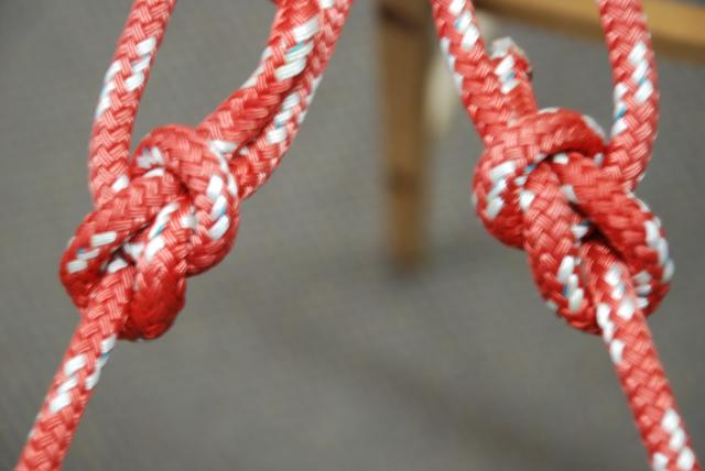

Most people make the knot facing the bow (with the jib either on the deck or hoisted). That doesn't work. Face aft so that the tail of the knot (after it comes up through that dagnabbit rabbit hole) is facing forward into the loop. The part of the jib sheet going aft to the fairleads is used to make the "loop" - not facing forward to the clew. Then the loop part of the knot used to UNDO the knot slides aft onto the long part of the jib sheets going aft, and not forward into itself.
Boat's on the hard :cry: so I just threw two bowlines around an upright.
The one one the left was tied "facing forward" and the one on the right was tied "facing aft".
Which one is better and why?
What am I missing?
Thanks,
Paul

The one one the left was tied "facing forward" and the one on the right was tied "facing aft". Which one is better and why? What am I missing?
They look the same to me, only appear to be left and right handed, rather than forward and aft as I suggested. The, for lack of a better phrase, "release" loop is on the bottom of each of your knots, along the long tail end of the sheet that would go back to the fairleads and the winch, and, so, enable easy knot release.
What folks do, in trying to make the loop through the clew as small as possible, in making up the knots looking forward as I mentioned previously, there's no room to undo the knot without either great difficulty, or having to cut it. If I get some time, I'll do a picture like you did.

Stu, the thought crossed my mind...
when you talk about looking forward or looking aft, are you talking about the knot itself or the person tying the knot?
If you're talking about the person, most folks I know always tie a bowline "as if they were facing aft". In other words, as if tying the bowline around themselves.
Tying a bowline "facing forwards" or around someone standing in front of you is a very different set of motions (hopefully, with the same resulting knot!!!).
