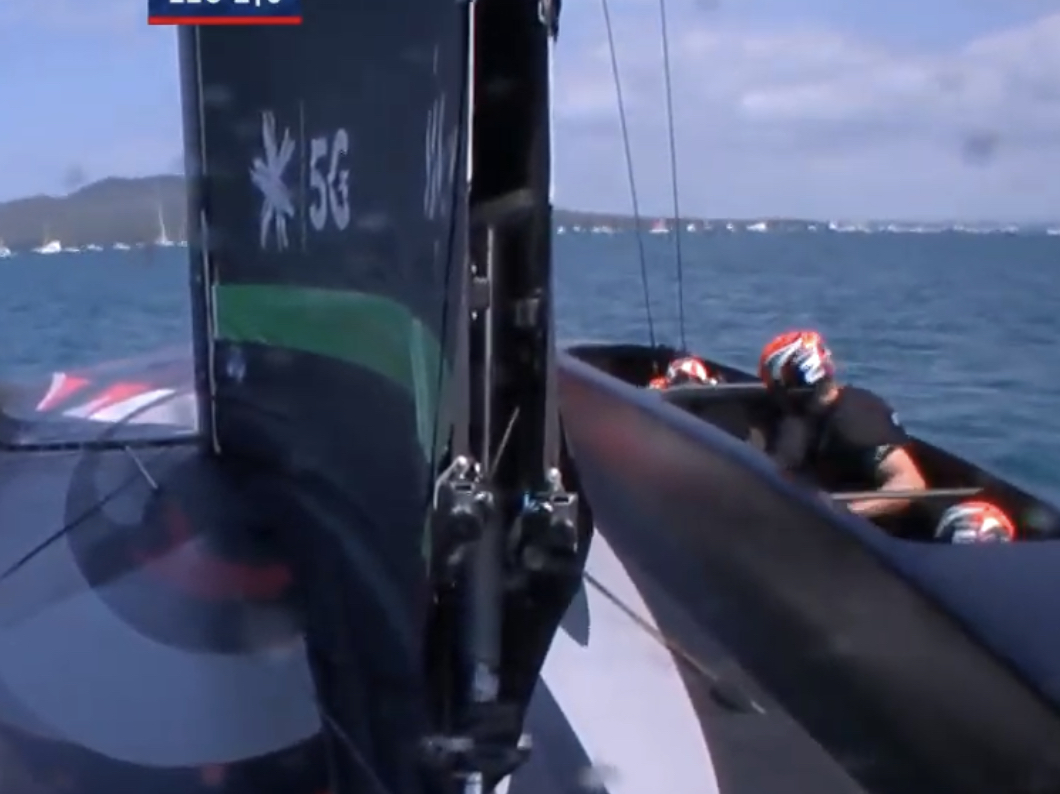

During the single race yesterday that was called on lack of wind - timed out, the commentators had a lot of time to ramble on :)
One of them spoke to a theory that the change in sail shape - draft was created by having the windward layer fairly flat while allowing the leeward layer to become more “curved”. When the boat starts to foil and pick up speed the leeward layer is pulled flatter. Hard for me to describe :)
I managed to grab one screen of the NZ main. LOTS of widgets in there!!!
