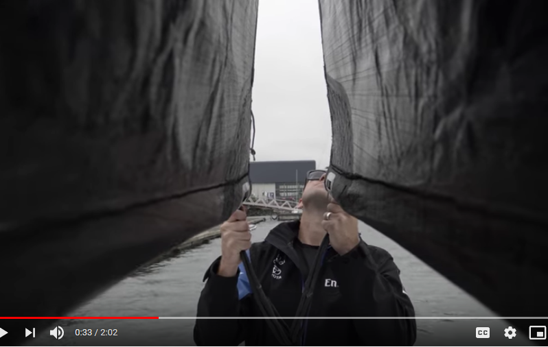

I saw a mention and in Youtube videos it looks like there are two sails sewn together with the cuts opposite. Apparently the pro's like them as there is very little flapping when tacking and they get into shape much faster. Always wondering when the trickle down technology reaches us.

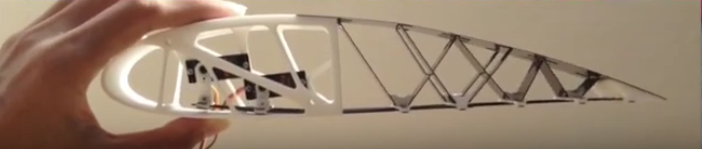

It's not really a double mainsail so much as a rigid wing with a joint to allow it to fold. It is a rigid structure that has a joint so that the back half of the wing can fold like the flaps on an airplane wing. Folded it is more powerful (generates more lift) but also creates more drag. As such it is like a lower gear. As the boat picks up speed the wing can be straightened out to a "higher gear". This is my understanding anyway. If anyone out there has more to add please do. I do know that the wing can only be removed from the boat with a crane. It cannot be dropped.

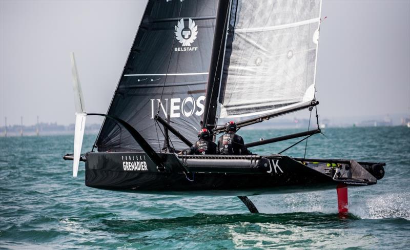

So the double luff sail ends up looking like a wing really looks? I'm not clear on whether they devised this sail in order to have a sail that can be raised and lowered and will prevent turtling. Or if they devised it to have a more efficient shape? That rigging diagram doesn't make much sense to me.
It sounds like they were trying to make it easier and cheaper to rig. They are also more robust than the catamarans. The last boat would need a lot of repairs when they capsized. There have been capsizes on the new AC75s where they just right it and keep on sailing.

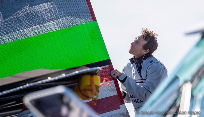

Interesting. Some have a boom and some do not. I read they can have tapered battens as well as a comment the batten makers should be busy trying things.
Interesting on how they attach with a single line with a Y type connected to both clews.
