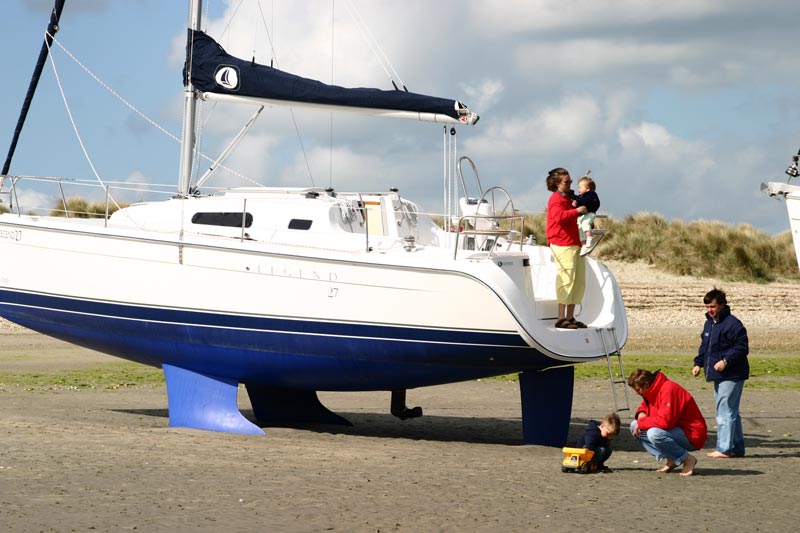

A number of years ago Hunter built boats in England under the name of Legend. The boats built and sold were the same as those in the U.S.. They did produce a 290 version with bilge keels. One of the British sailing magazines ran an extensive side by side test between a bilge keel version and a fin keel version. The outcome was that there was very little difference, if any, between the boats on all points of sail. In short, it came down to the proficiency of the crew. Apparently a well designed twin keel boat is not all that bad. The caveat being well designed.

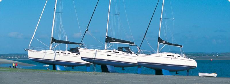

Some British harbors have 30 foot tides so at low tide
many boats are sitting on mud which is the reason for that. There is going to be some trade off with any configuration but for the most part they sail pretty much the same and given the circumstances it is a good trade off. Another option used there is large hydraulically operated centerboards. I rode on a 32 ft with a hydraulic centerboard and was impressed with the performance.

Bilge Keels have used for over 60 years and longer. The Westerly line of sailboats, a UK manufacturer, makes many bilge keel models. Some tidal areas have huge differances between low and high tides

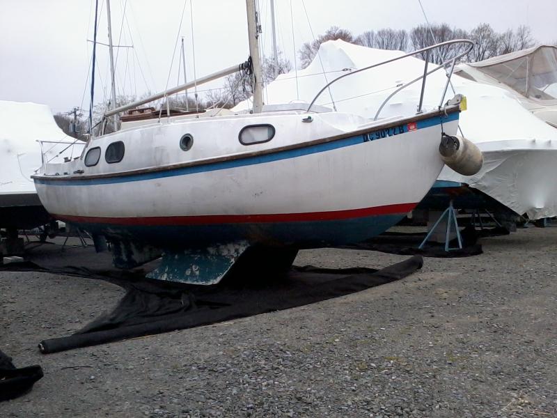

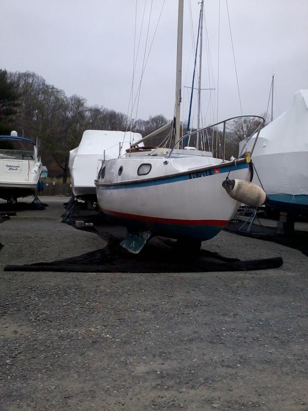

MrUnix, those pictures almost make me want one. Could be it is all about the destination. :D

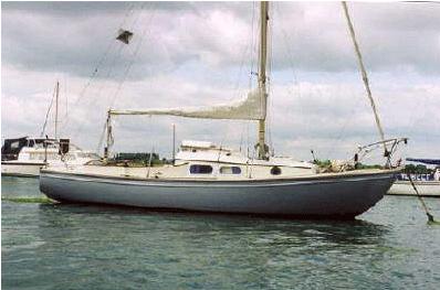

I have owned 2 twin keel boats. The first was a Westerly 25 (that is a Westerly Nomad 22' in the opening post) and they were the largest of many UK twin keel boat builders, and as posted you still have a choice of twin keel boats new in the UK. The second was a 35' designed locally. Both were good boats for cruising although for racing not as good. Neither is an Alberg 30 or similar a good racer really.

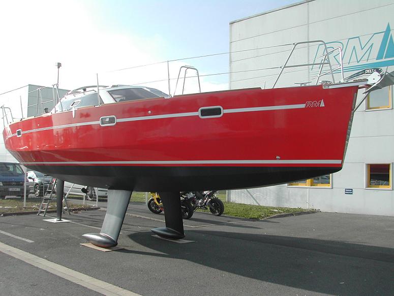

There are performance boats with twin keels as well.
First pic is a Westerly 25 and the second an RM, built in France and not exactly a slug. here's a link to RM Yachts.
