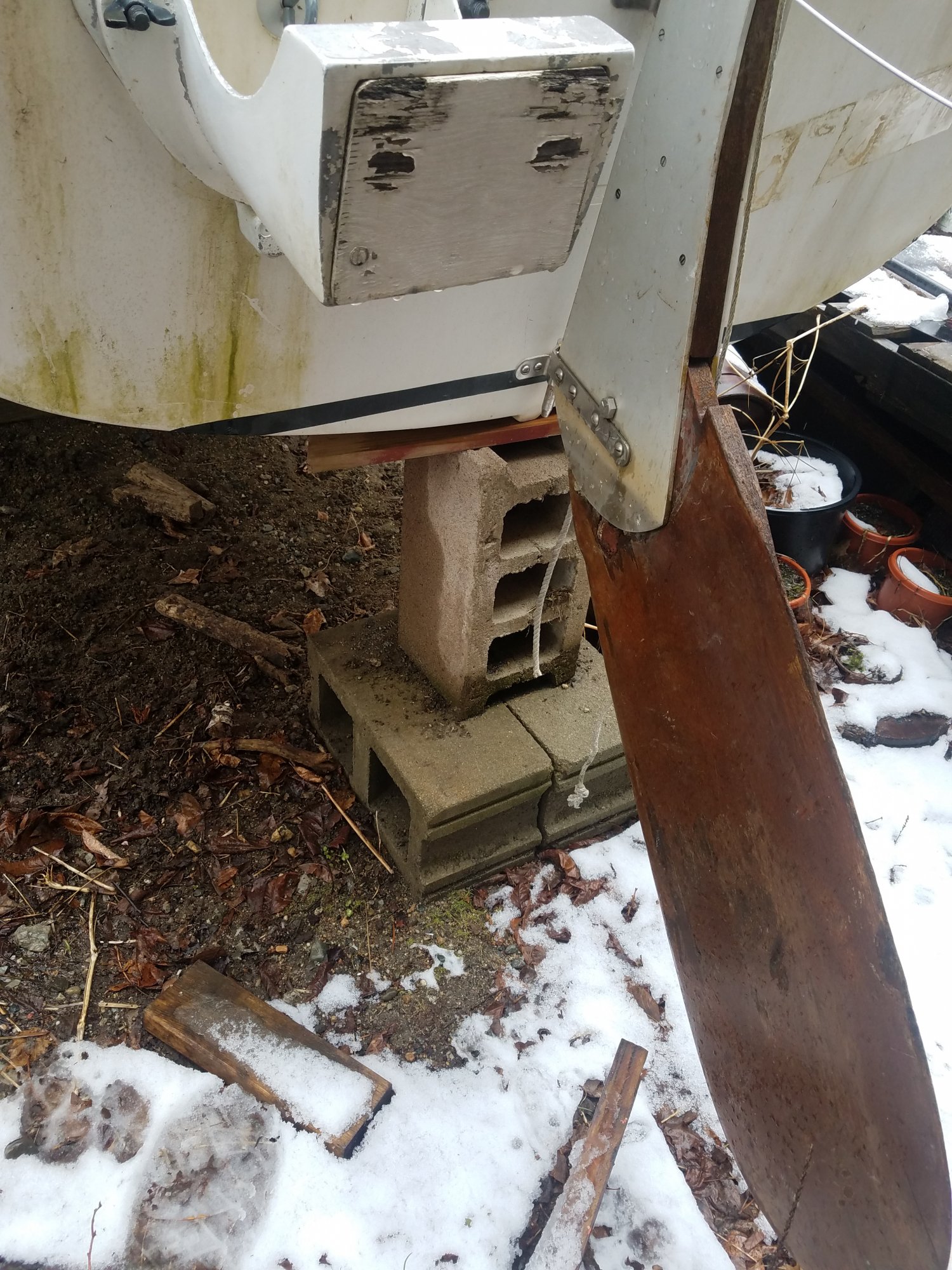

I will also add that sailboat trailers don't always have enough tongue weight. The marina I was at last year said they always put blocks under the back of sailboat trailers.
The first time I put my boat on it's new trailer I found out the hard way. When I detached the trailer the tongue went flying up in the air. The only thing that stopped it from tipping all the way was the safety chains. 375lbs of humans on the tongue was not enough to bring it back down. If you ever encounter this and human weight on the tongue is not enough you can use your tow vehicle's spare tire jack on the rear of the trailer frame. Issues with tongue weight distribution should be fixed before attempting to tow.
This is a good practice in general. Even if you have plenty of tongue weight, walking around on your parked trailered boat can cause dangerous pitching. I read about a guy who had to crawl under the cockpit seats to reach an electrical connection to his sternlight. When he got all the way back there, he found himself pitched head down in a confined space. He was lucky to have help nearby.
