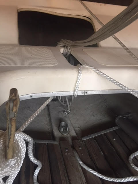

Post pictures of the mast step and the mast base so we can see the challenge you are facing,

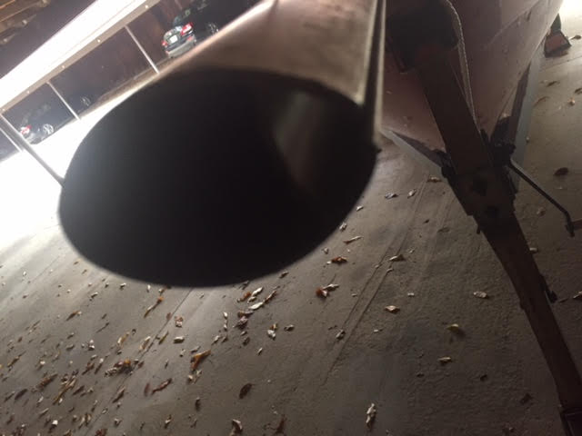

Ok. That helps.
So the way I would approach this is to epoxy a wood block to the hull, maybe 6 inches, in front of the metal base plate. It is a spot to rest the bottom of the mast against when you go to raise the mast. (Right now there is not a good place to brace the mast bottom so that you can leverage the mast up to vertical. )
Attach the side stays. Get a helper to pull the jib halyard (connected to bow, with helper standing in front of boat to hoist the top of the mast while you push and guide the mast up from inside the cockpit) as I suggested. You leverage the mast up against the block. As it goes up it is less likely to turn or twist. With someone holding the jib halyard they will be helping to stabilize and pull the mast top forward. When you have almost reached vertical with the mast you step forward and raise the mast to position the mast on the base. The mast will then be vertical and when you pull the jib halyard forward you can then secure the bow stay.

John, the problem is he has no helper. He wants to do this solo. But you have a good idea with the block of wood.
You can make a "guide" so when the mast is started up it will have something to work against. John is right that there is nothing there to keep the mast from sliding deeper into the bow. I would think that by your self, once the mast is in the slot and against the guide, the rest will be somewhat easy. just have to make sure you have the headstay right at your fingertips so you can move forward to attach.
Taking the mast down I would think would be easier. I imagine just lifting and using the guide to prevent the mast from sliding forward, you can walk it back. I would still recommend some kind of gin pole/painter's pole to use as leverage.
What am I seeing in the second image?
24,938
Brian, I think the second image is the base of the mast.
