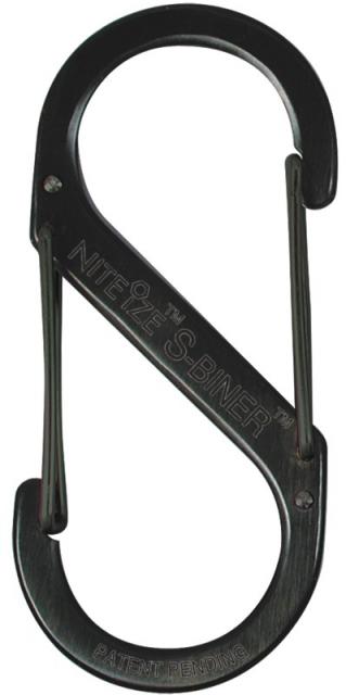

Nelson has given very good advice. My rig is similar to yours. I have added two items that for me make reefing quicker. First, a S-binder is used to attach the luff cringle to the jiffy reef hook. This is much easier and quicker than trying to fit the sail cringle over the jiffy reefing hook. Second only one line with a hook at the end is used to control the leech. This line is one of the existing lines fed through the boom. It is hooked to the leech cringle and simply cleated off at the mast end of the boom. [FONT=&quot]a separate line is tied through the cringle and around the boom pulling the cringle tight to the boom. This line is much like the other reefing mid-sail lines. But in this case the line is drawn tight to the boom not loose, as the midlines should be. Also when moving to the next reef higher up the sail this leech cringle line is left tied to the boom. I carry a number of aprox. ¼" lines tied to the cabin top rail for this and other “need to tie quickly” purposes.[/FONT] If another reef is needed the hook is taken and moved higher up the sail. I find this simplifed system much easier to use without all the tangled lines. It has the benefit of no lines when the reefs are not used as the leach line hook is attached to the boom when not in use. With our boat's relatively short boom this one line system works well. It likely would not work as well with longer booms.

Your modifications sound intriguing and sounds like it will work better than the stock setup. I was wondering about how well things would work with the reefing lines continously rigged. After my storm event (and epiphany) I'm sure it is better to be rigged and ready, but I can imagine them giving me grief when raising the sail. I think I'll go with your adaptations including the 1/4" lines. I'll have to find a couple of those S-binder hootigators. Thanks again all. Everyone's comments were very helpful.

Only one S-binder is needed. Put it on the lowest luff cringle and move it to the reef point you use. You can leave a reef in the sail as you wish. It actually makes it easier the next time out if there is a string of strong windy days.
