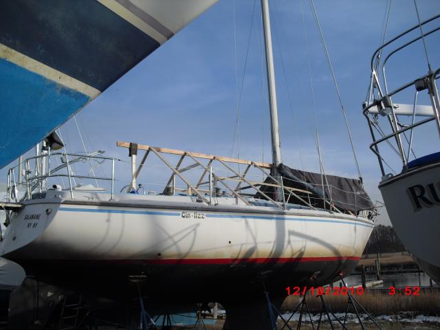

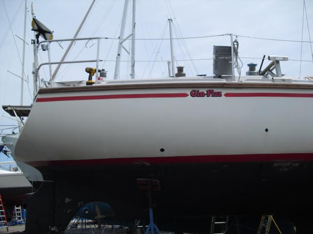

If you wanna save yourself a ton of work. wipe the old stripe area with alcohol to get off grime, and go over it. I just did mine last weekend red stripe over 20 yr old imbedded blue one, it looks great. Tape was cheap, use that elbow grease on another project. Red
