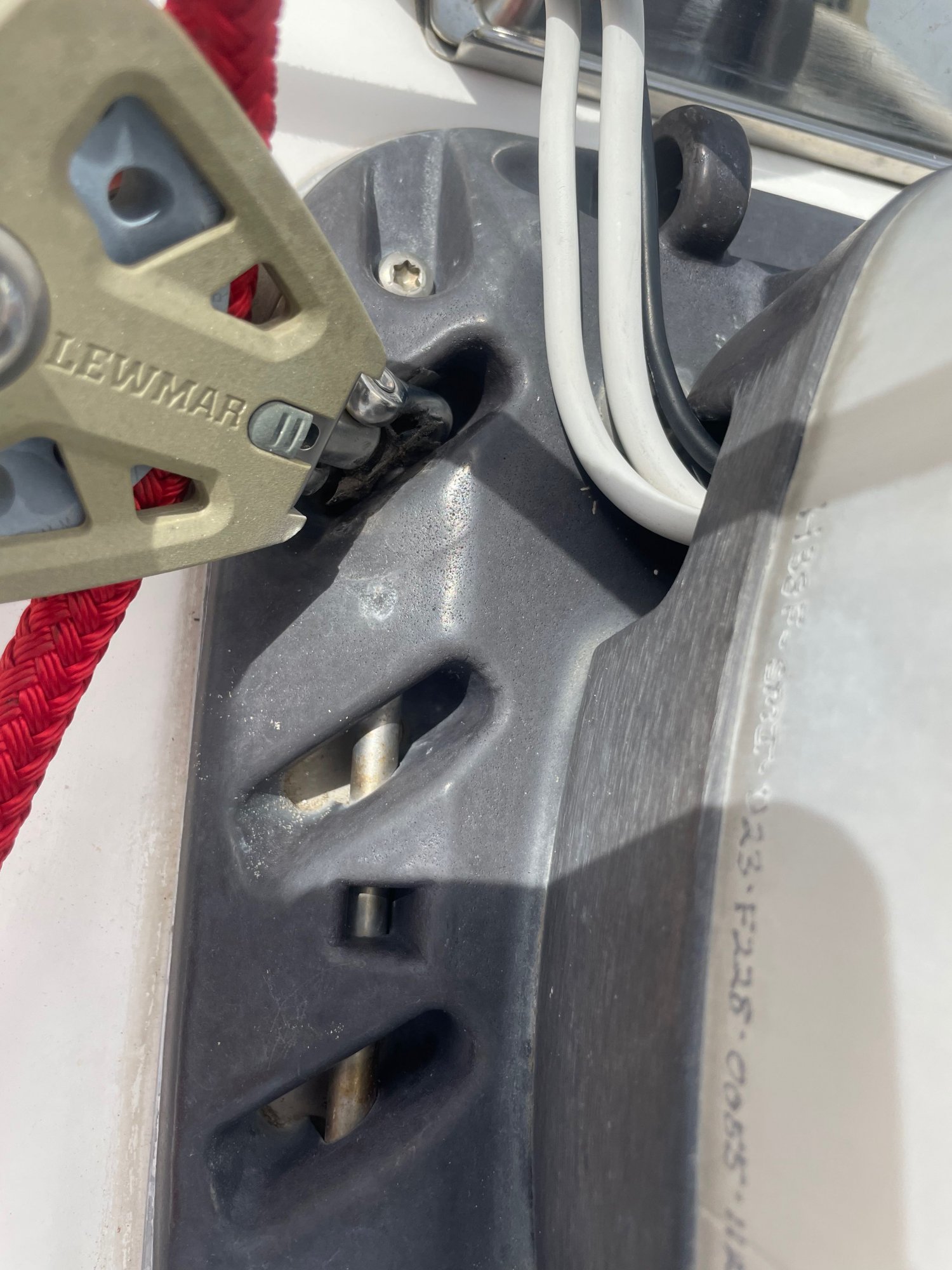

There is a fore-aft ping running through the casting at the bottom of the mast around which the shackle of the blocks is attached.
I thought I could just slip the shackle bow of a new block around the pin in one of the empty spaces. It turns out the ends of the shackle bow are too fat to slip around. It looks as though I need to remove a torx head screw and somehow extract the pin and reinsert it with the new shackle bow in place.
Is this correct or am I missing something?

Try to remove the one that is already installed without removing the pin. If you were not able to then you are right, the pin needs to come out. If you remove the pin, then add more shackles in unused slots for future.

ok I found some instructions buried on Selden site. Looks like I'm correct that torx screw and shaft are removed. Anyone done this and have any tips for me? Its probably never been removed since the boat was originally commissioned.

You need to break up any mechanical bonding that has occured through the years. The day before you plan to work on it... squirt some PB blaster into the recess areas... then the next day...before you start messing with it... give the end of the pin a few gentle raps with a hammer. A few taps on the head of the screw would also be a good idea.

Well this turned out to be easy peasy. Wish all jobs were this simple.
I couldn't get the torx head to budge so I shot a little PB Blaster on it (HATE their new spray can flip up nozzle contraption) and waited a couple hours while I did some other stuff. It came out without any major cursing.
The rod slid out towards the front very easily, although I had to maneuver it around some of the cables coming out of the mast.
Obviously you do need to make sure any lines running through the existing blocks are unloaded, but that's no biggie.
