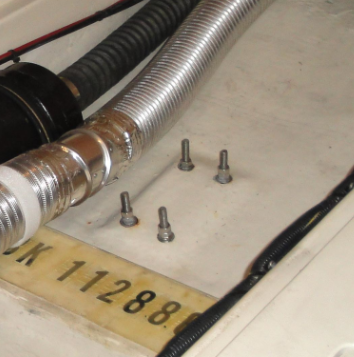

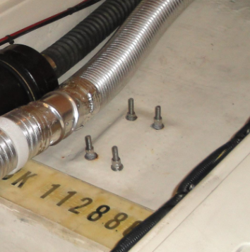

There's a pic floating around out there that shows the end result. Basically the glass needs to be cut away at the base of the strut.
1,085

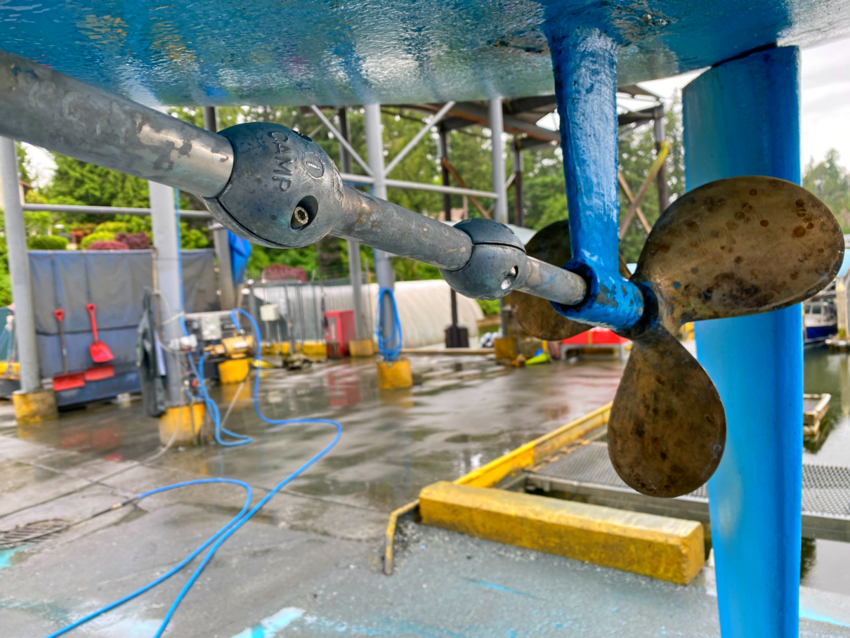

Not in my recollection. Did you/do you own a Cherubini-designed Hunter 37 Cutter? The strut was a Dahmer model H-34, now sold by Miller Island Propeller. It is a two bolt strut, bedded in something like polysulfide. Remove the two nuts inside, screw out the bolts from below, and pry the strut of the hull (a heat gun may assist). I can assure you that no cutting glass was required!
