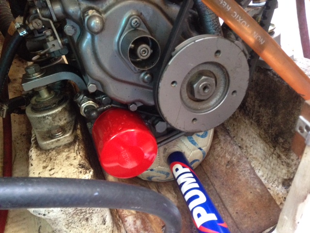

On my C30, I needed to remove the transmission. My oil pan was in good shape( not rusted). I loosened the top nut on the rear mounts and did use a deflated soccer ball followed by blocking to not rely solely on the ball. My mounts had a threaded stud on top and lag bolts at the base, so two to three inches was all the elevation I required

Basketball works fantastic, use an electronic tire pump for speedier lift, conform to the engine, lessens the potential for damage and you can roll the engine a little to adjust the engine to align it to the shaft.
