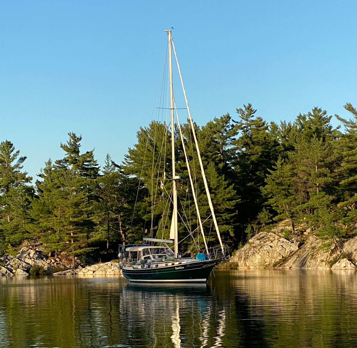

In Marianne Cove in Baie Fine in the North Channel of Lake Huron, we anchored about 10 feet from the west shore. This cove has 360 degree protection from wind and waves. It has good depth right up to the shore. So like others there, we dropped our anchor in the mud toward the center of the cove, then backed up close to the shore in 10 feet of water, then we took a line ashore and tied off our stern to a tree on the shore. Then our companions in their Hunter 30 dropped their anchor to the right of ours, and backed up until we could tie their port side to our starboard side withe appropriate fenders between us. We spent two days there, hiking ashore, and #nug as two bugs in a rug!
Here is a photo by Julie Thorndycraft of the Great Lakes Cruising Club of a much larger boat tied to the east shore in a similar fashion. There are a number of similar anchorages in the North Channel, and the similar waters on the west coast of Sweden north of Gothenberg. There you can often find mooring rings installed in the granite shore to tie off your stern.

Thinking about the OP's query, with no granite shore line to tie to, he could take a line to shore and sink an anchor into the beach. It would align his boat with the Gulf wave action and perhaps give him a little piece of mind.
