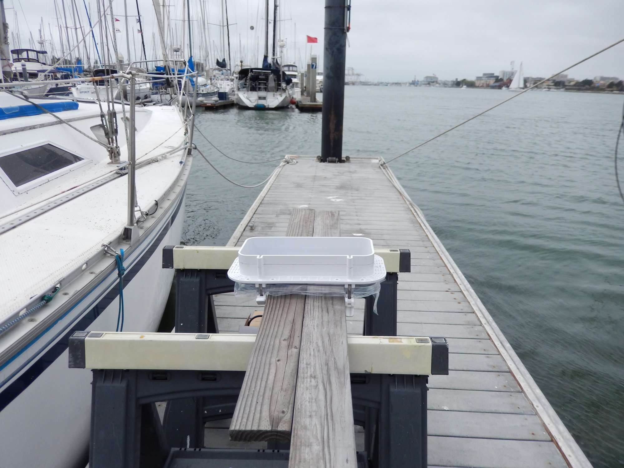

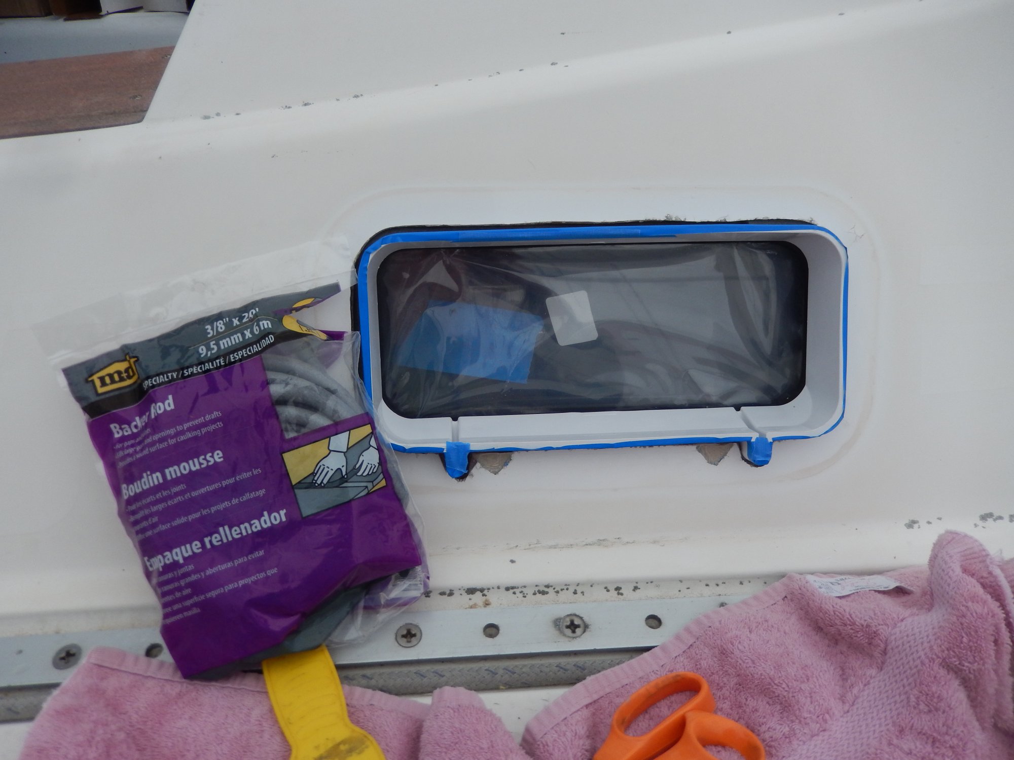

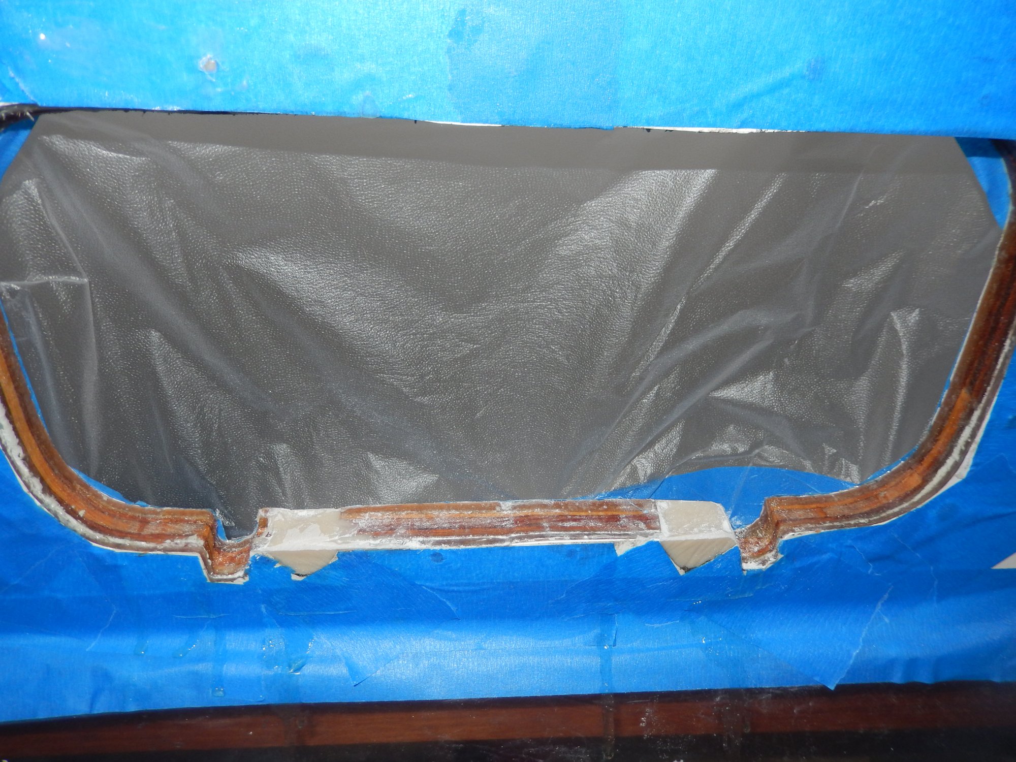

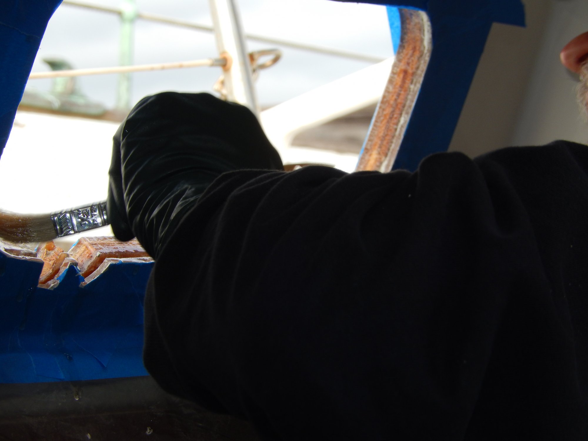

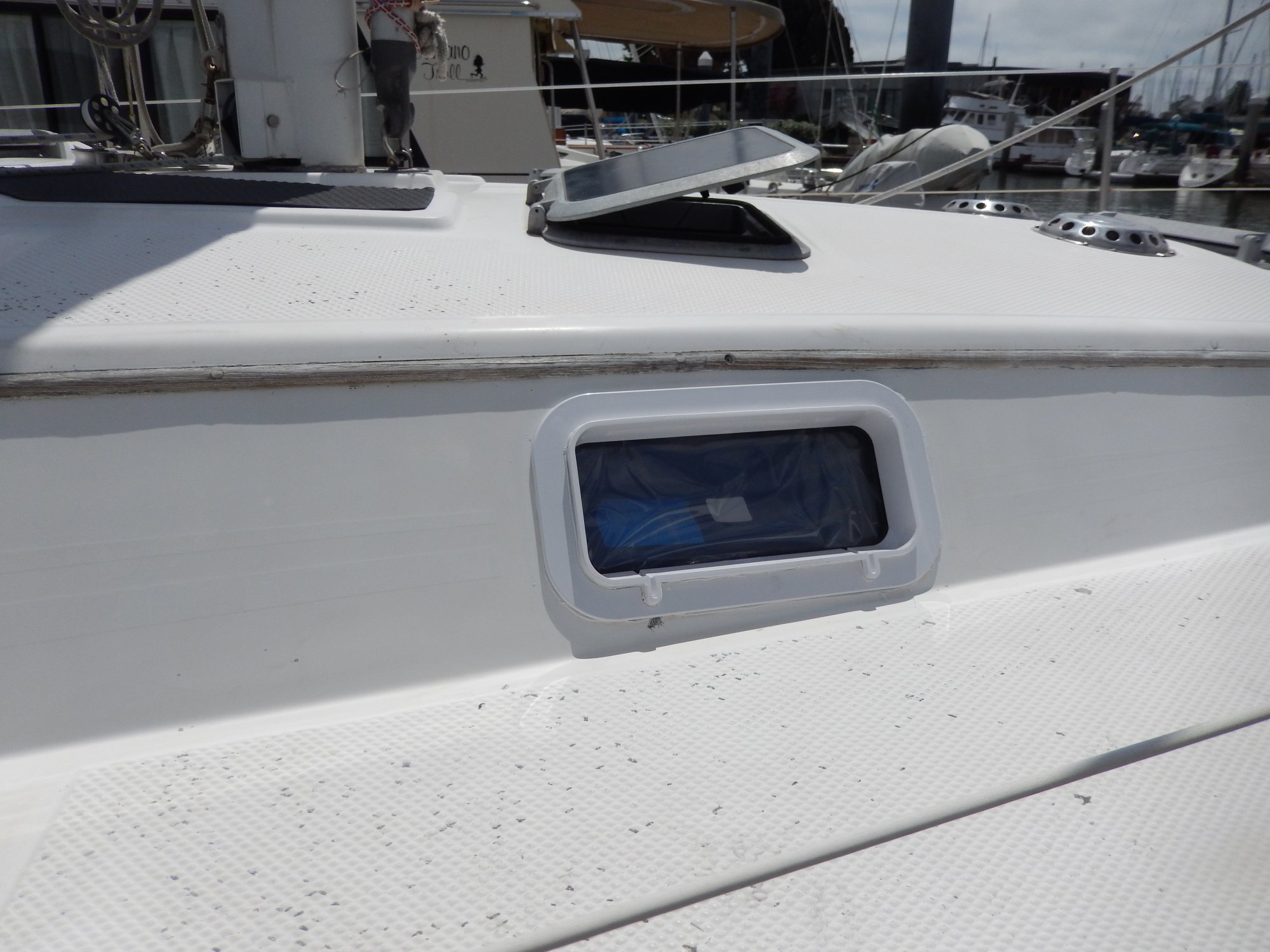

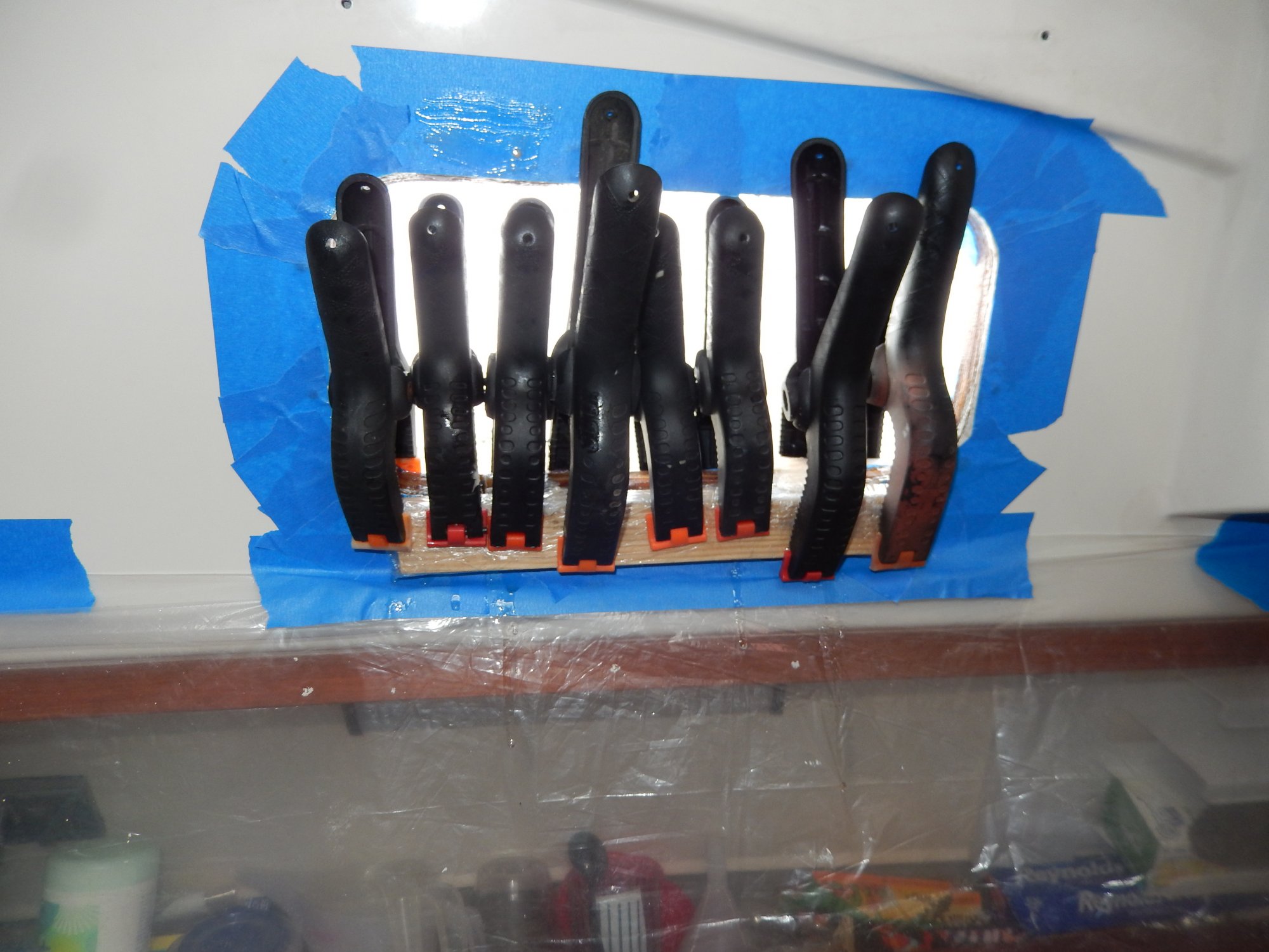

My 1985 34 of the same vintage as yours also came with the Gray Enterprises Portlights. They were the same size as @kloudie1 has described. I decided to upgrade mine to the Beckson. The openings cut into the cabin top had a bit of margin, but not a lot. The flanges on both sides cover the holes. It took a bit more effort than I expected. Be patient. I did have some water intrusion on a couple that required me to dig out the rotten plywood core material and fill it with thickened epoxy. Also I discovered that the inner liner was not adhered to the plywood core. That was only bonded to the exterior skin. I chose to fill that gap with pieces of cedar shims (available at Home Depot) saturated in epoxy. Then I coated the plywood edge of the cut with more epoxy. Also, the rain drains were in slightly different places so I had to fill the old cut outs and cut new ones. You may have to trim the extension for an even reveal to what you already have. I used an oscillating multi tool with a block of wood for the proper distance. Maybe these pictures can help a little. Good luck.

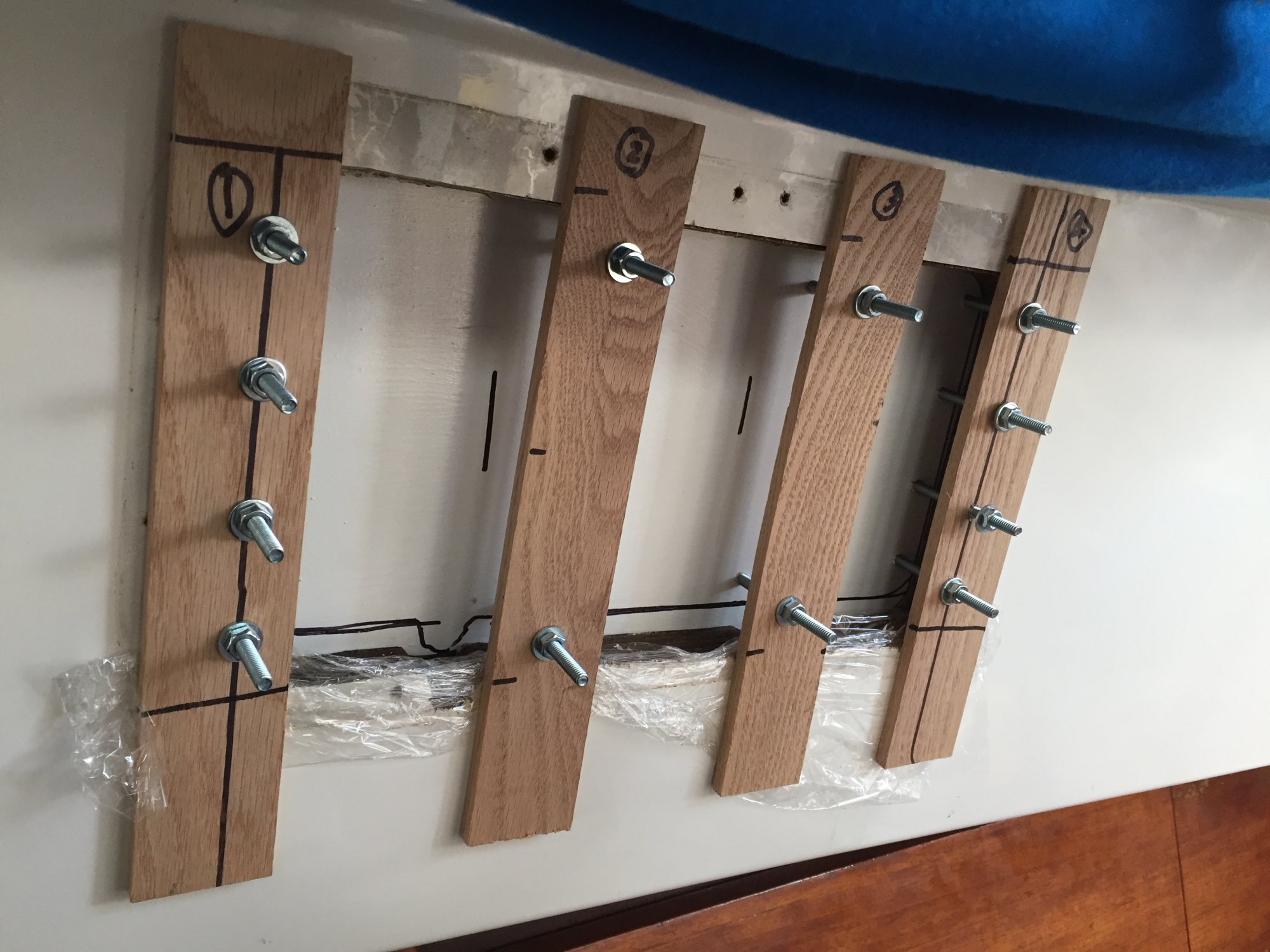

I'm intimidated by this job, because I'm worried I'll get the old one off and the new one won't fit
I suggest you make temporary covers to put on during the job. I made several, as shown in the picture, the cheapest easiest way possible - scrap 0.25" plywood, scrap flooring boards, bulk 0.25" carbon steel bolts nuts and washers, cheap weather stripping on the outside.
This job is pretty much guaranteed to develop hitches when you find water damage or have to do some cutting and fitting. This will allow you to work on more than one at a time and make progress while the glue hardens - takes all the drama out of it.
