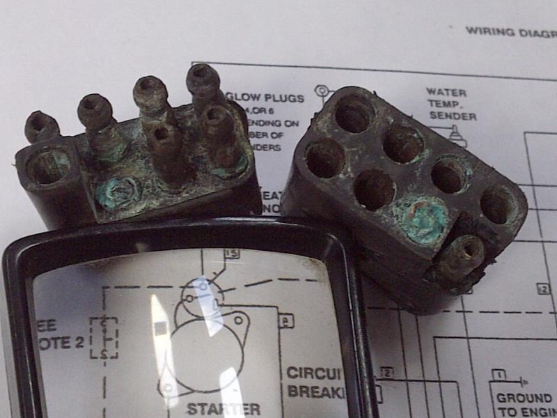

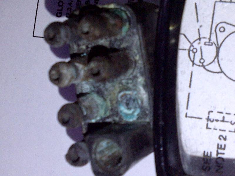

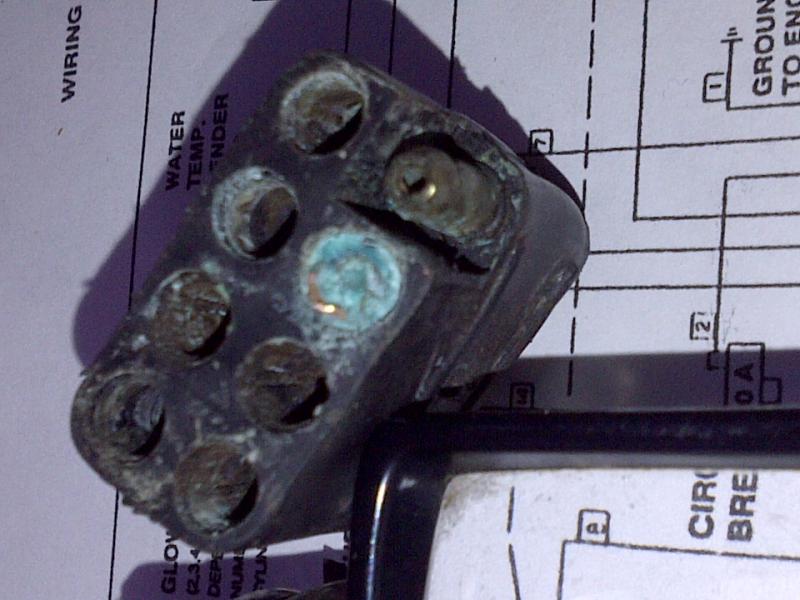

Oct 17, 2011
2,809
Ericson 29 Southport..
While I haven't had any problems with this plug yet, I decided to investigate it after reading Maine Sail's article about it.
This was a while back, but I did now WANT any problems either.
And while this is not the "correct" marine crimp for this, it's better than what was there, and I intend to do something else later..
