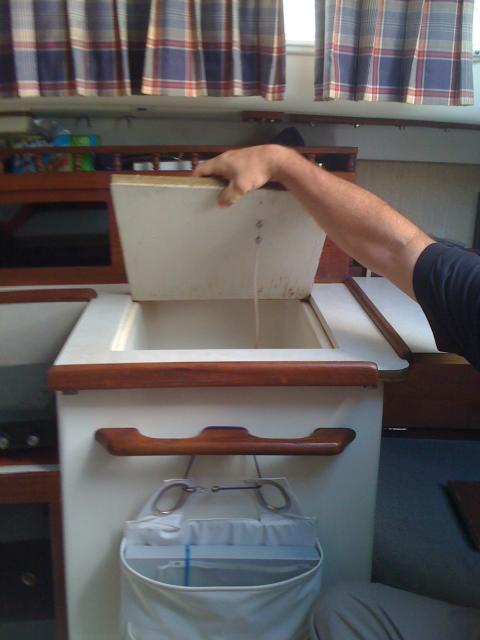

So the huge gaping void referred to as the ice box ('instant cool water maker') has me thinking--of warm beer and soggy sandwiches.
How easy and practical would it be to strip out the existing ice box and fit in a small standard ac fridge in its place? I won't be doing extended sailing for a bit, but what if we did go for a week? Would there be a better cooling appliance that wouldn't break the bank?
(small alternator 55amp, ancient atomic 4, no generator or inverter, due for a charging/battery system replacement too)
What do ya'll like for refrigerator needs on a small older boat?
Thanks.

What about just wrapping more (or better) insulation around your ice box? a friend of mine with a Cal 37 has just an ice box, and that sucker would keep ice ice for a good two days, block ice even longer. He also had a couple of plastic crate-like racks on the bottom of the ice box. The racks would be on top of the ice, the food and .. well, ok, just beer, would go on top. it stayed cold AND DRY.
Ross
Jun 15, 2004
14,693
Four inches of foam insulation on all sides and the top including a well fitted lid will keep cold with gallon jugs of ice for a week.
The crates get me thinking about cutting the available volume in half since I don't really need all that cold storage to keep cold. Reducing the volume in half and then placing crates atop ice block sounds like a good idea to consider if not retrofitting. Thanks!
OK, following that thinking, why not just put a lot of insulation INSIDE the box: takes up space, reduces the volume inside, and is always easier to do!

Stu, I was considering that too. Do you think the rigid foam board insulation from the hardware store would fare well as the ice melts into water? Or is there a different type of insulation you are thinking about?
23,530
Lotsa different material out there. Go to Home Depot and look around, ask what's waterproof, 'cuz you're bound to get it wet sooner or later. Also, figure out a way to remove it, 'cuz the next owner might want a full sized fridge.

20 Ounce soda bottles also work well for ice. The extruded foan is great and you fill the joints with Great stuff canned foam to glue it all together then sand it fair. Spray the inside with 3M adhesive and cover it with fine weave fiberglass cloth or even polyester fabric then paint a couple of coats of epoxy on. Mine is done that way and has be completely trouble free for ten years.
