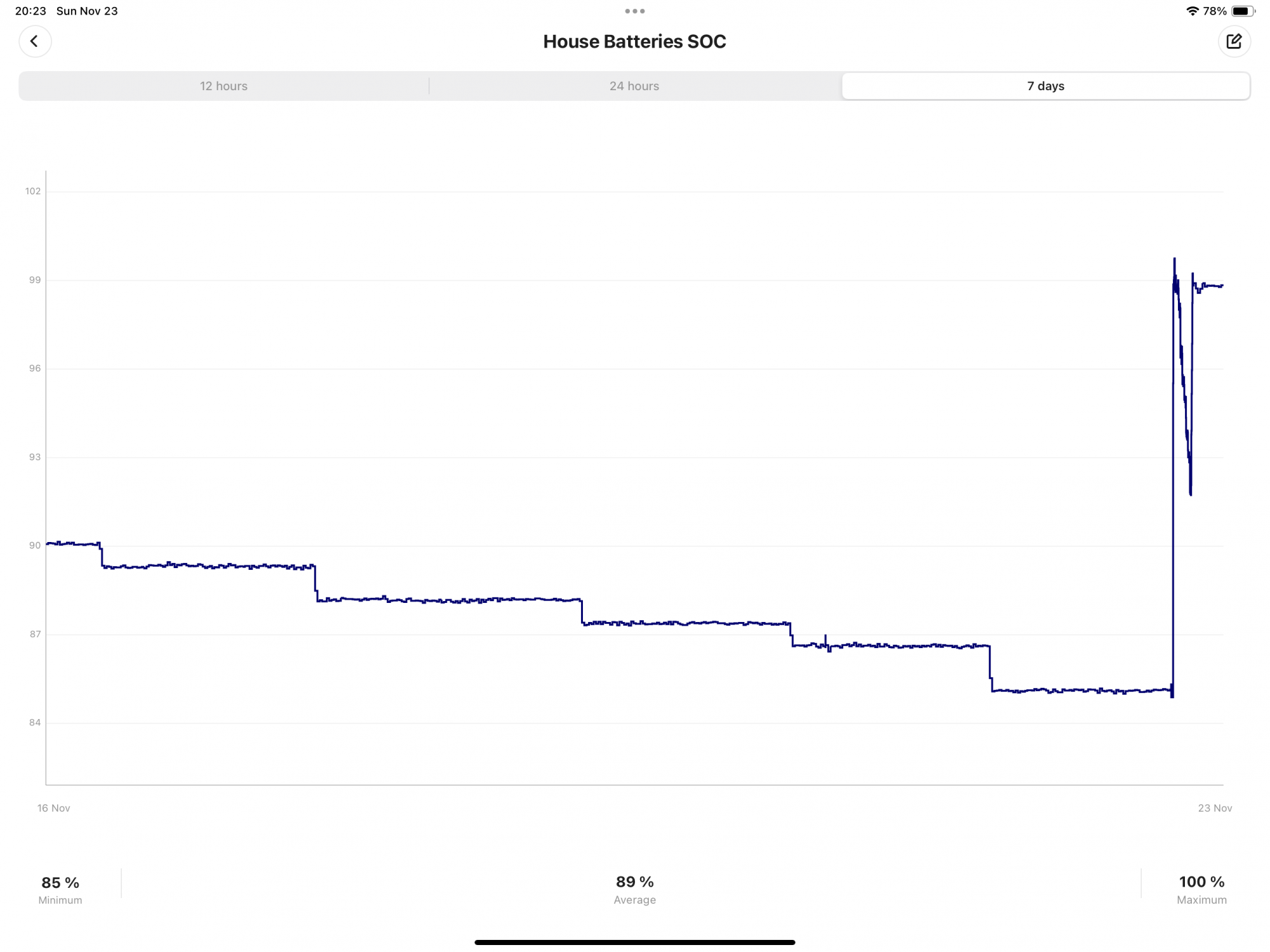

Hi all,
Newbie here but I am out of ideas and hope you can help. I have a 2024 Oceanis 40.1. While on shore power the House SOC continuously drains 1% to 2% a day. I thought this might be a battery preservation program but apparently not. I have seen it drain all the way to 30%. If I start the engine it charges right up and then drains right back down. I have asked our maintenance team and they have asked Beneteau but just crickets. I think there is a miswiring in the converter or perhaps a short somewhere. We have lost a couple of house breakers that have been replaced under warranty but I think something else is going on.
any ideas?
Thanks all!
Dan

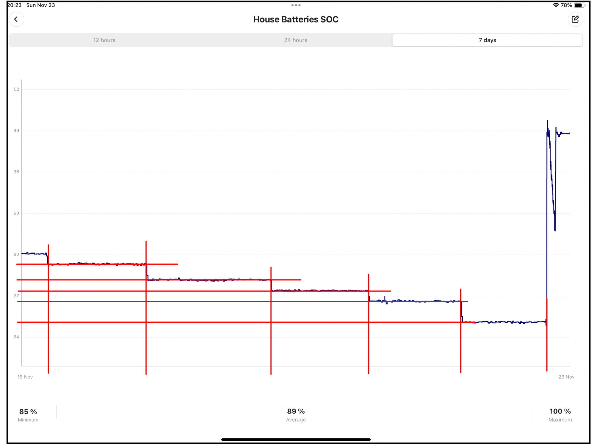

@Decisions , by your chart it looks as if there is a periodic discharge of ~1% SOC which occurs every ~1.2 days in a very short period of time, maybe one minute or less. Assuming that the representation of the chart is proportional to the electrical discharge.
Don't know the size of your battery bank so can't say how many amps this represents but it's fairly large. Of course your batteries are not being charged at this time.
I can only suggest you invest some time in looking for this source of heavy discharge. Sorry, but I can't imagine what the load might be. Bilge pump maybe ?
Hook up the charger to your batteries and see if this phenomenon disappears. If it doesn't, write back. Doesn't tell you WHAT is pulling the amps but puts you back to the correct operation.

That’s 1% per day more or less, and I am not sure why the drop off. It almost feels scripted. The date scale is at the bottom, and you will note that it is from 16 Nov - 23 Nov. I appreciate the direction. Ultimately there isn’t anything terribly mysterious about this. Battery’s are draining and the shore power isn’t charging. A volt meter should tell me what’s up. I will let you all know what I find out. Won’t be back on the boat until about 10 Dec.
Thank you!
