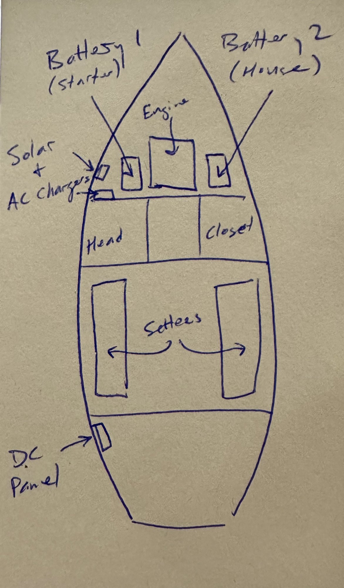

I'm wanting to upgrade the house battery bank on my Yamaha 30 (v-berth engine), but despite my research I'm still pretty confused and could use some guidance.
Currently, I have a West Marine group 27 flooded starter battery and a Duracell (Batteries+) group 27 flooded house battery. 80ah, I believe. They're charged most of the time by shore power via a ProNautic 12-20p, and 200w of solar running through a Victron 100/20 MPPT. I'm unsure of the alternator's specs, but I'm guessing it's original to the boat and the Yanmar YSM12 engine. We don't usually have a large energy expense, and we can typically stay out for a couple nights without issue, as long as the sun cooperates and we turn the fridge off at night, but I'd like to have more capacity to work with for longer trips that involve more sailing and less motoring.
Here are the issues that have me stumped right now:
1. Having everything located up in the v-berth area makes it difficult to place larger/more batteries anywhere near the chargers, so I'll probably need to find something low-profile and/or sealed, so it can go in the limited space under the settees. I measured, and I can just fit two group 31 batteries on their sides, but I haven't found a non-sealed battery that fits the space.
2. I was thinking AGM, but then I started reading on here that I probably don't have the proper charging system to support the needs of AGM, and that my setup could be detrimental for the longevity and/or safety of those batteries. Am I correct about this, given the equipment listed above?
3. Placing batteries half a boat away from the charging components has me questioning cable sizes and prices. If I already have a dedicated starter battery and a portable backup jump-start battery, do I really need to account for the potential draw of the starter when I size the cables?
Is there something else I'm not thinking of? Probably! I'll take whatever advice I can get, though.
