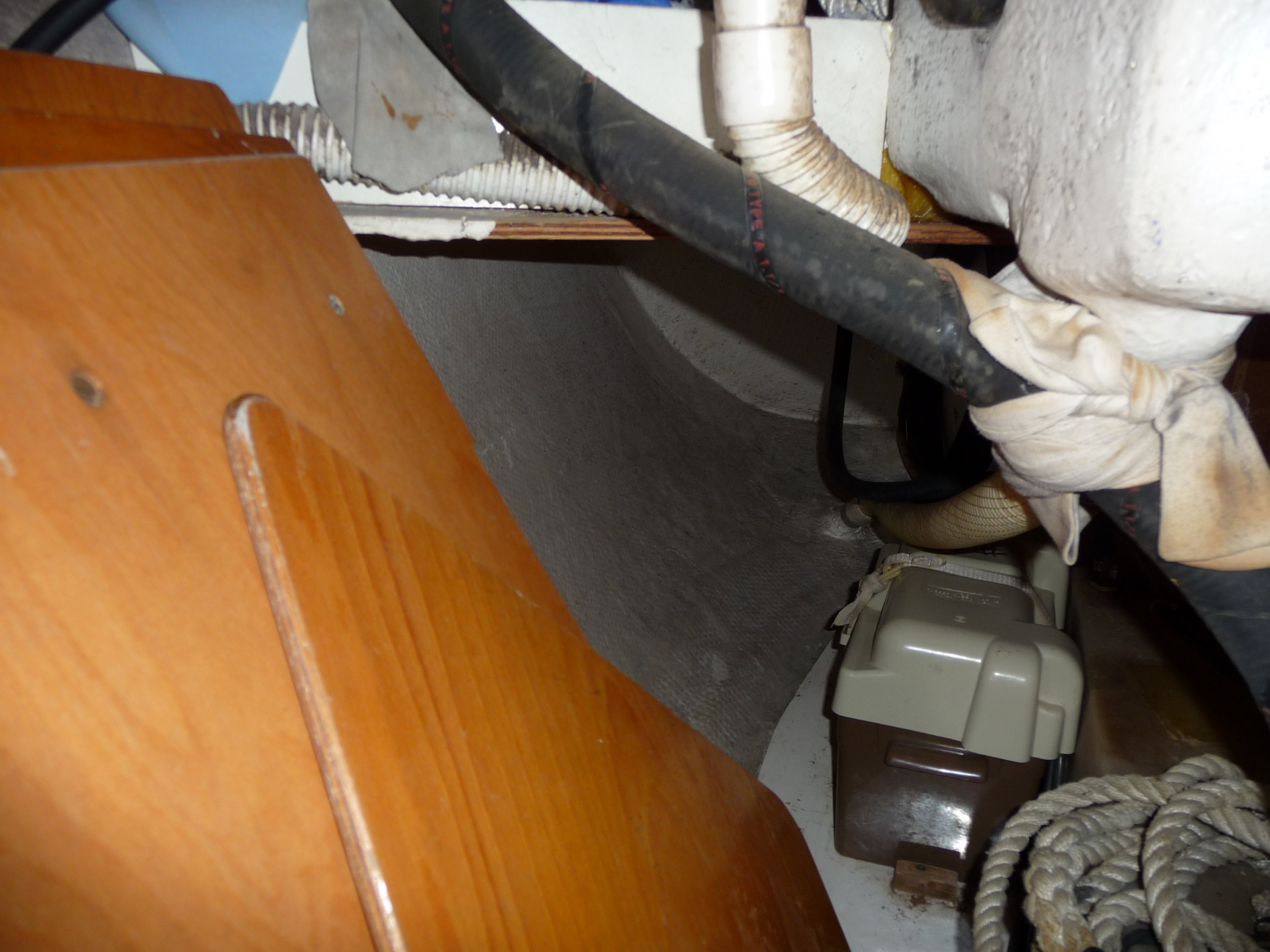

When I purchased my 34, there were 2, 6V golf cart batts behind the ice box and one size 27 aft of that, next to the fuel tank. There was refrig, instruments, and an autopilot. It all fit OK but getting to the aft one is a bear.. I converted all lights to LED and had a fridge failure. I removed it and so really didn't need the 6V stuff. I now have 2, 12V size 31Duracells and that is ok. I would go back to the 6V's if I were using the boat more.. picture is of aft batt location. Ya need to install remote watering to keep 'em happy
