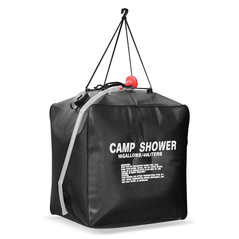

Our small 4 gal. tank is well insulted, but the real "hot" water is mostly gone by late the next morning. OTOH, running the engine at a fast idle will bring it back up again in about 25 minutes.
And, yup, those "solar shower" bags will heat the water enough to hurt you, on a sunny day. :)

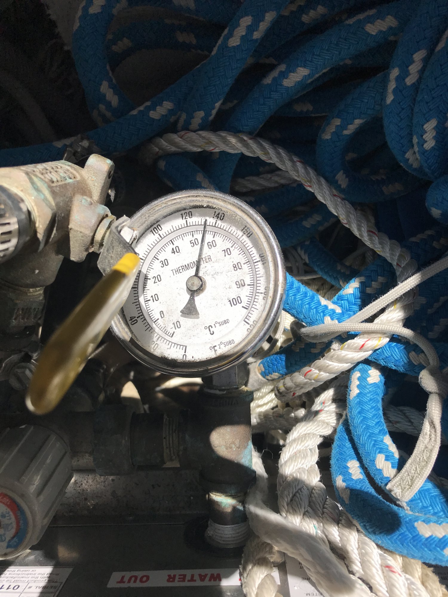

Suggest that you instal a brewers thermometer with a deep stainless probe in your hot water outlet fitting (just use a T fitting). That way you can determine if your tank is hot enough for a shower or if you need to run the engine.

if your hot water tank is not looped to the engine then as someone posted you can get a camping shower bag that is heated by solar which works quite well. We used to have two that we tied to the deck during the day and then place them into a insulated cooler with a few hand warmers and they lasted about twelve hours until morning.

Yup, we have a solar shower for backup. Boat has a 6 gallon hot water tank, heated by element under shore power or freshwater cooling from engine heat exchanger while underway. It does keep heat well for a day or so, just thinking of those additional days. I have yet to turn on the engine to heat up more, but that may be the simplest way to go, burn less than 1/4 gallon of diesel at 30 minutes of 1500rpm. I wonder - we have plenty amp hours, maybe I can use the inverter to heat up the element? It seems not to be wired in this configuration, but I’d like that option as well. We plan to add solar, and that would likely more than make up the difference.
