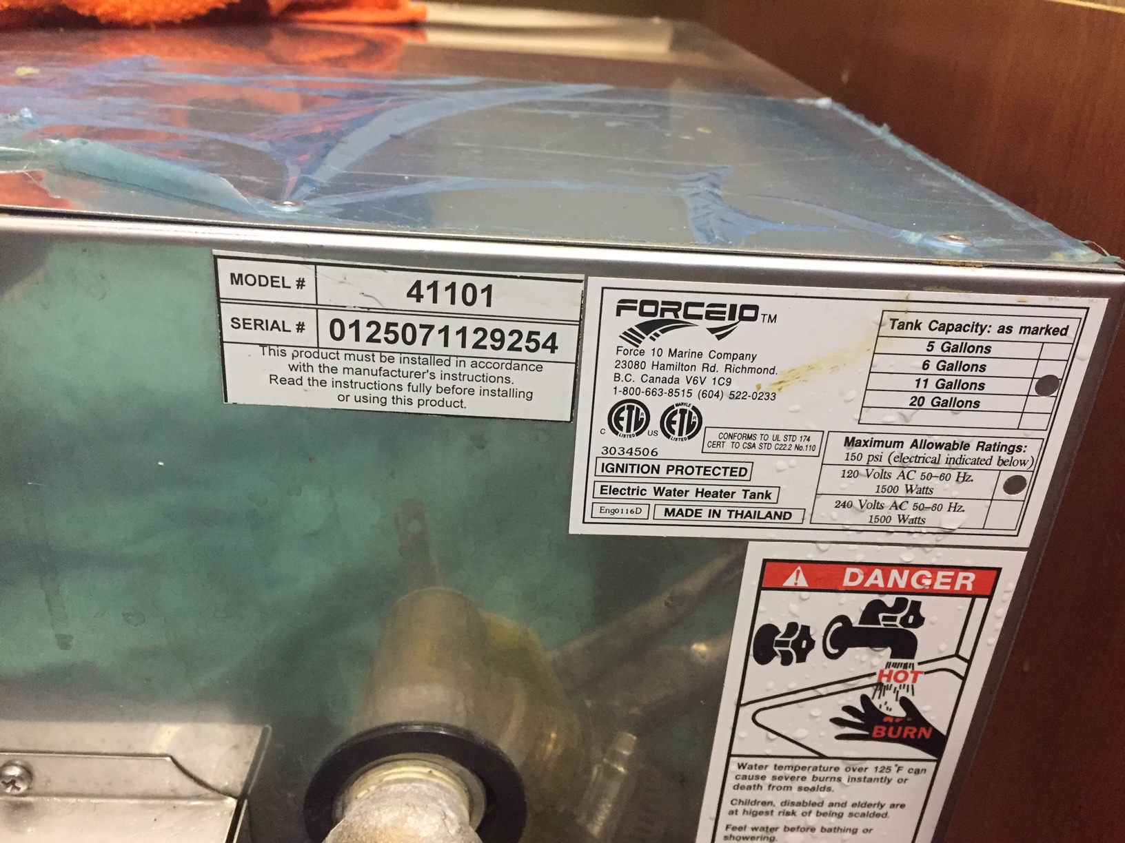

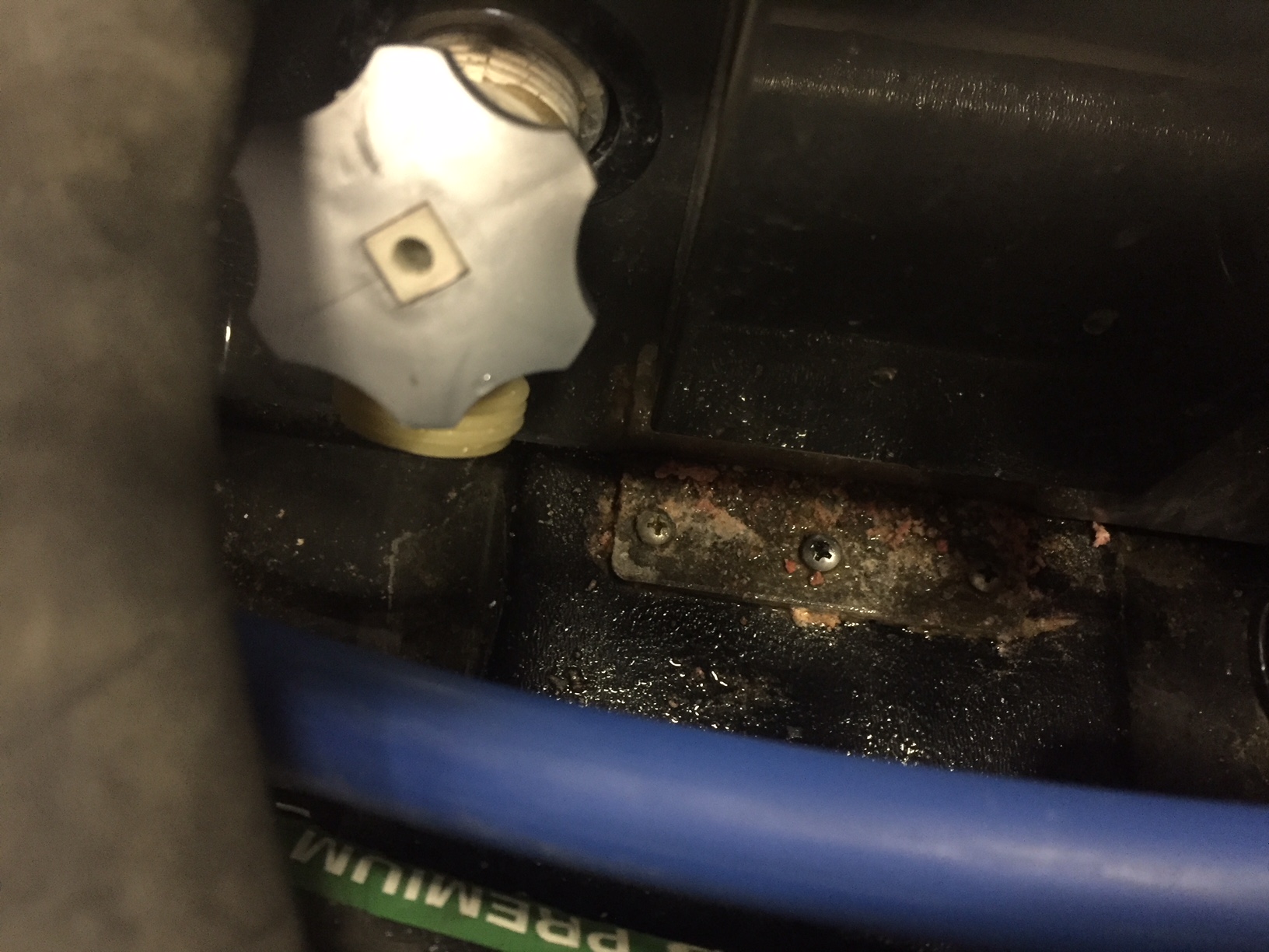

Hi All,
I have 2008 Hunter 41 and have exactly same leak from heat exchanger, I bypassed the water heater my pump stop and proved the leak is from heater also I have notice when heater is on and water is warm my pump run more frequent which tells me heat exchanger expands and I get more leak, pressure valve and all the lines are dry.
Is there any fix for stopping leak or do I have to replace the what heater?
attached is the Pics taken from water heater
Thanks
Rick D
Jun 14, 2008
7,208
Nothing practical. Replace it. Be sure when ordering to get the fittings in the same place. It varies.
