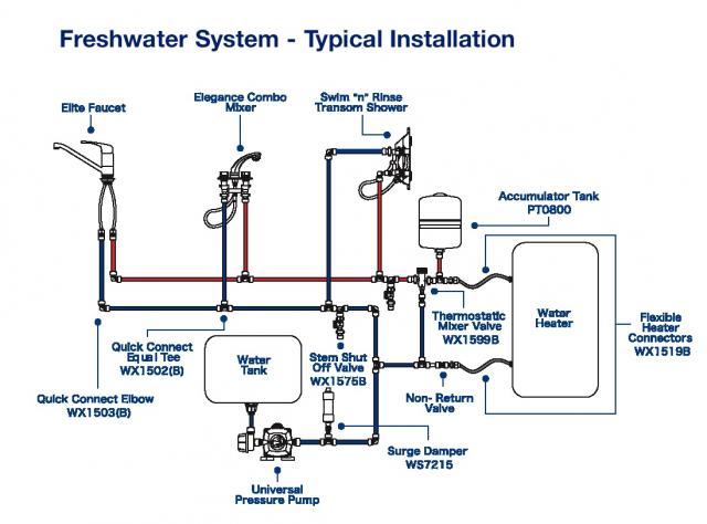

See attached schematic of my water system (mine has no accumulator tank).

Are you trying to heat off the engine or off the shore power. You also have a mixing valve in that system, did you adjust it?

Yesterday I solved the problem with my water system. As I said in my original email when I disassembled the brass stem fitting from the steel covered hot water input line (the one with the check valve in it), the washer was destroyed and I removed only see part of it. Well yesterday I found the rest of the washer logged inside the check valve fitting. I removed the left over black rubber washer material from inside the check valve with a pick and reassembled the fittings with a new washer and everything worked as intended. I suspect that when the Catalina technician who was working on my boat during assembly - tightened the brass fitting to the male end of the hot water input hose so tightly that it cut the washer allowing some of it to become logged inside the check valve. It took some time to discover this because the valve seemed to work correctly when I tested it by blowing and sucking on it, but when hooked up to the water system the higher pressure caused the check valve to fail. So in short there was no problem with the Whale components of my water system, rather the problem was with the assembly process.
