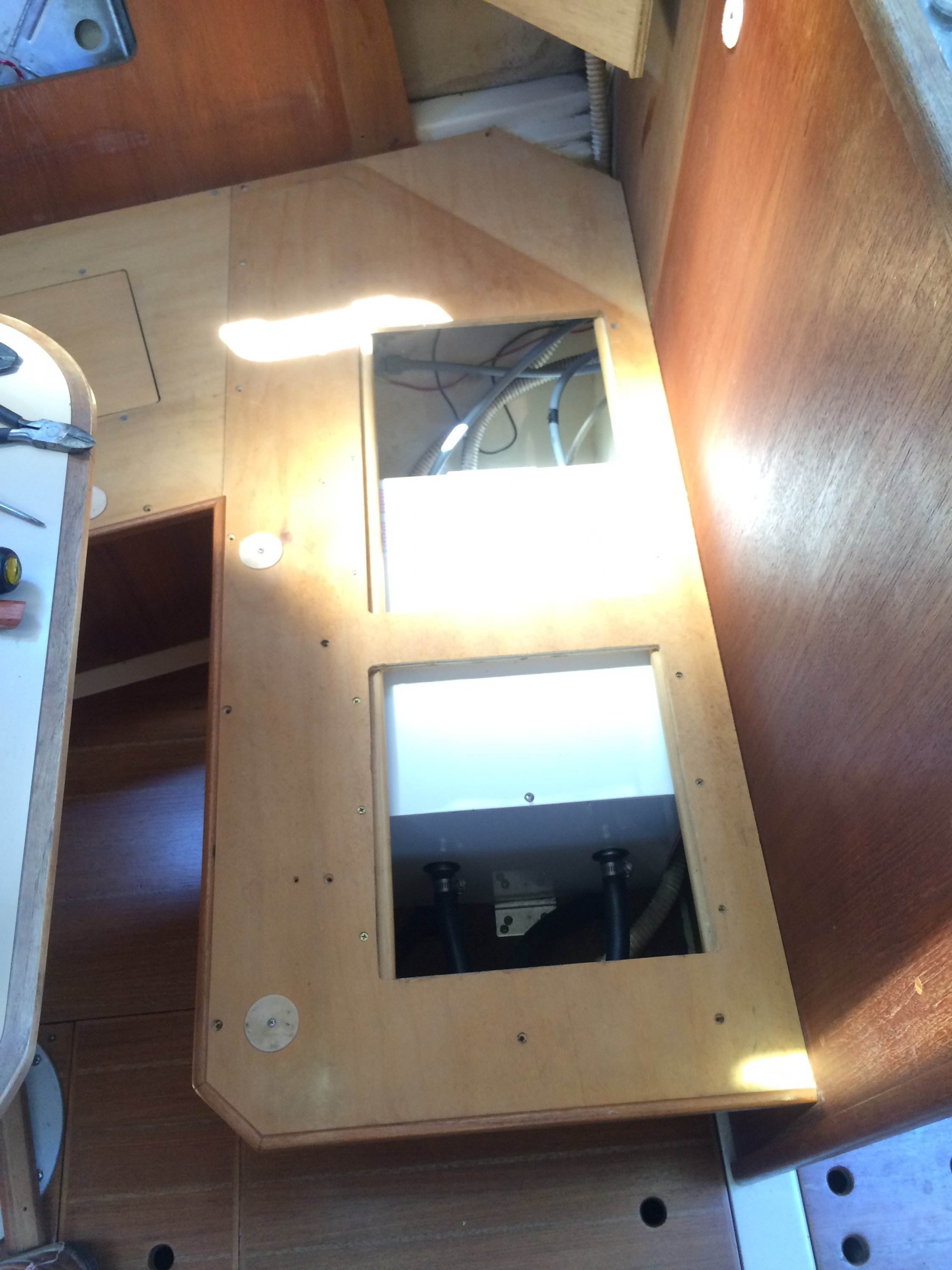

I did this on a 1990 H30. I cut a new hatch in the settee plywood flat rather than try and take it out. I spliced the new hose onto the old with barbed fittings and duct tape and pulled the new one through (I'm too lazy to read the C34 post to see if they did the same). The picture shows the new hatch needed to get to the hose side of the water heater. A few years later I did end up having to take the seat flat board out to replace the water heater, and this picture is from during that work. It was an effing pain.

Thanks so much for reply and picture, looks like I need to get a good jig saw. For now i'm going to disconnect at motor and jump the inlet/outlet with a short piece of hose, thanks

I used that job, cutting out the hatch, as a excuse to buy a Bosch palm router. I was worried that a jig saw would hit the water heater. On my boat there was not much space above the heater.
