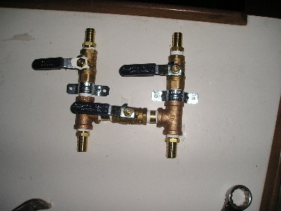

I had to replace mine a few years ago, used a wet-dry vac to clear the old coolant, but you've already got that advice. I would recommend you install a bypass valve to prevent the need of worrying about this in the future. It will allow you to isolate/bypass the water heater.
