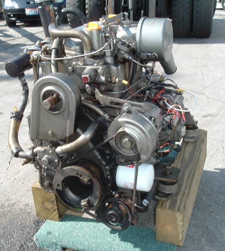

Here is a shot of the hot water plumbing (hosing?) on my buddy's 1978 H-33. It gets the 140 F water from the block to heat the water and gets the water hot in about 20 minutes. We have had problems with the nipples plugging with a white putty-like deposit (every 5-6 years) but when the water flows it works quite well. Hot water leaves the top front of the block by the lift lug. Returns to the fitting on the forward side of the exhaust manifold. The heater replaces a short jumper hose on those fittings.

Ed H, the engine in his 33 is a 2QM20H.. original to the boat.. Thing about the hot water here is that the raw water temp is usually above 68F.. and the ambient is only cold for short spells.. It is 79 F here right now.. but was 29F a couple of mornings last week.. The good thing about the QM engine is that there is a hose that connects the water from the block and head to the exhaust manifold; there is no cast-in passage. So all the hot water from there has to go through the water heater exchanger before going to the exhaust.. That water is much hotter than the stream leaving the thermostat where the bypass water flow has mixed into the stream which goes then to the mixing elbow. On the raw water GM models, the stream from the block and head is not available; the stream that is directed to the heater includes the cold bypass flow.. not as warm..

Some of the QM engines had a heat exchanger added to them after they were born. If you are in warm gulf water that may help too, but try heating 50+ deg. SF bay water.
10,152
True.. some did have an exchanger.. I think Ed S. had some shots of a factory one, and another guy on the forum had a aftermarket one on his 33. This one is raw water for sure.. earlier this year we were looking for overheating and found a half of a fish in the thermostat. Removing the parts cured the overheating ..
