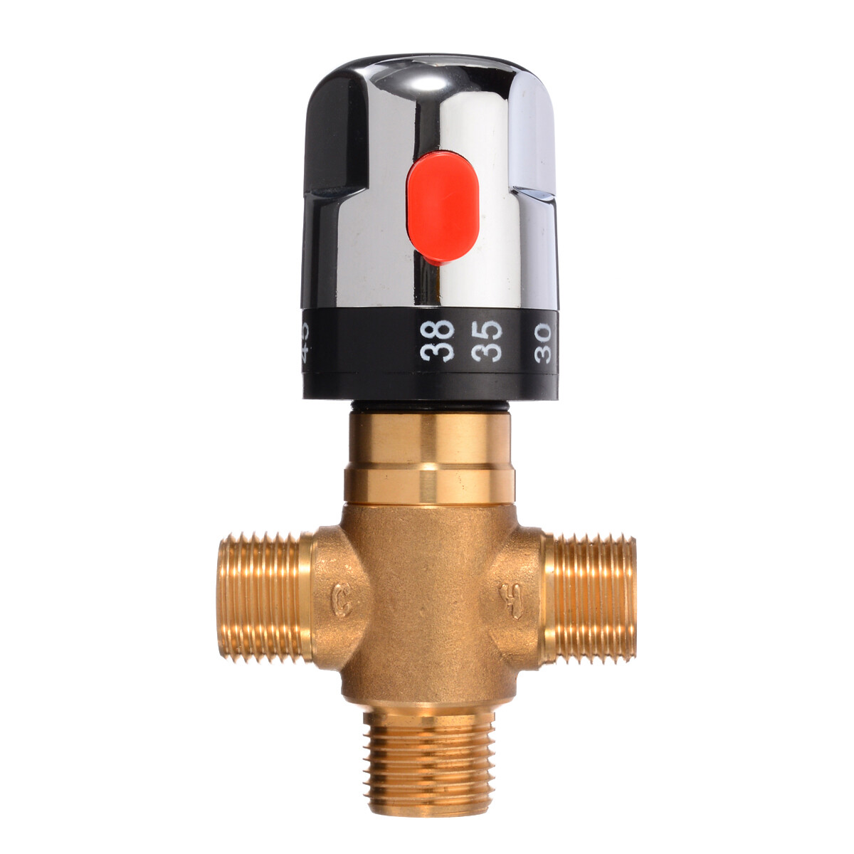

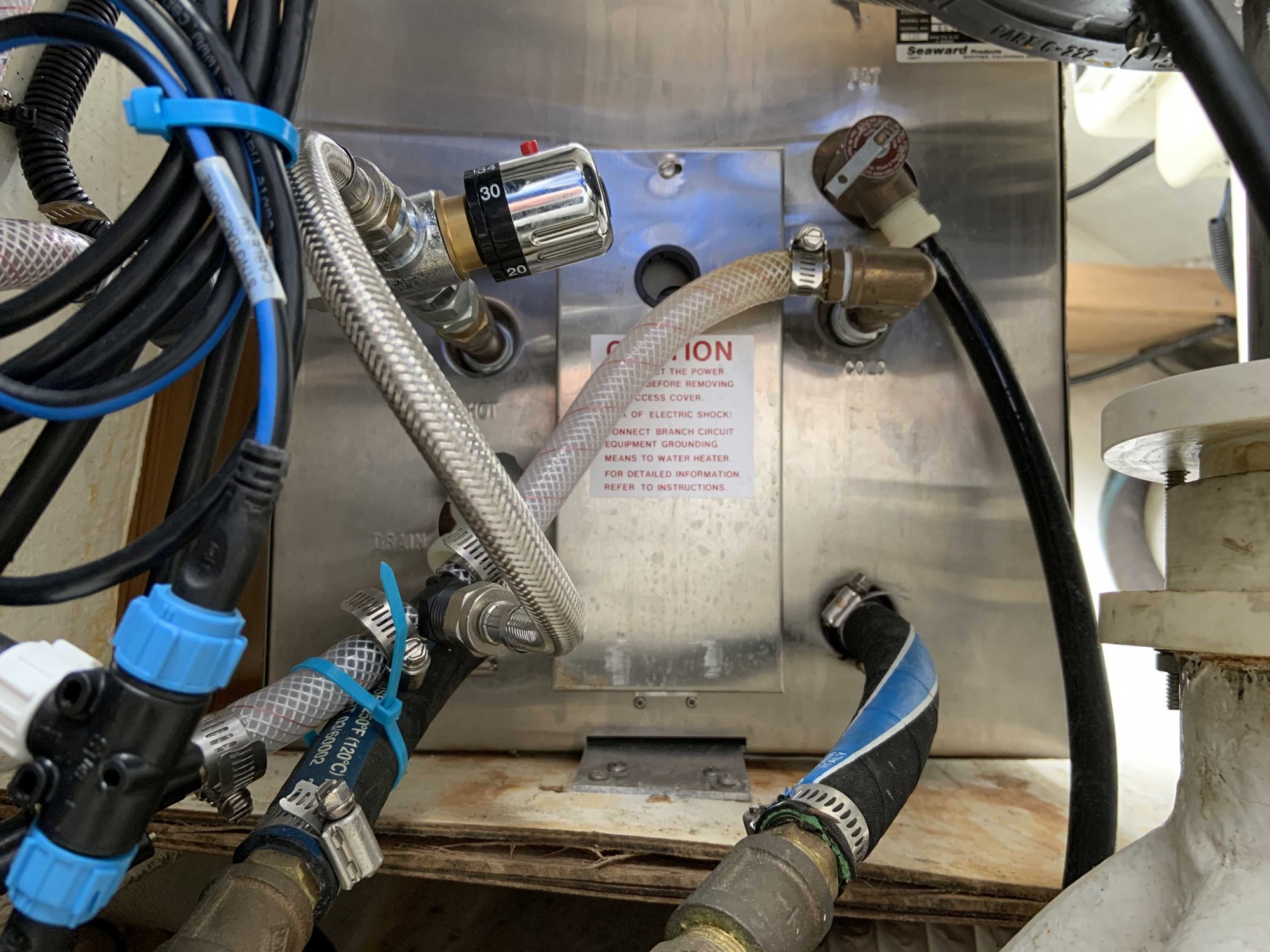

Not sure what a tempering valve is. Is it like a "mixing Valve?"
Yes, it is. It has three ports, hot in, cold in and mixed out. There's a way to adjust it, too.
Here's mine:
Unfortunately it's in Celsius, but I've never see none of this type in Fahrenheit.
The trick is finding one that will work at the low rates of flow we see in boats.
(I haven't installed mine yet.)
8,050
Beneteau 323 Annapolis MD
Here's mine:
That valve looks just like the one I got online. I have it on 38, which is 100.4 on my chart, and I can use it as-is- without cold water added in. The hotter settings are too hot for skin/hands. On 38, the first couple seconds are a little hotter, so either make a cup of tea with it, or wait a couple seconds till the 38 comes out. It is one of the best upgrades I made.
