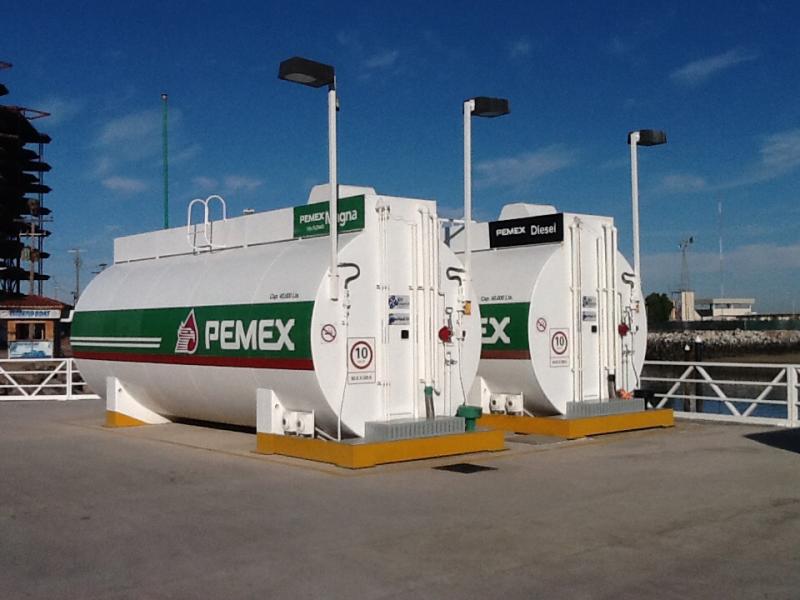

Dunno about the East coast, but there's plenty of gasoline in Mexico.
