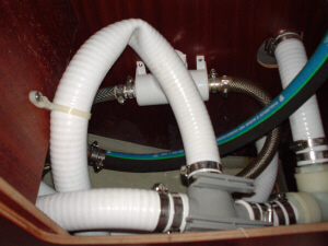

Inline radius fittings have been around for decades. If the hose doesn't want to bend that much CUT IT!! and use one of 'em. And/or, if the discharge fitting on the toilet is a straight, but you really need a 90 (or vice versa), CALL THE BLOOMIN' mfr and get the 90 (or the straight fitting)!!
As for getting it on and off the fittings easily...ever heard of a blow dryer (or a heat gun IF you really know what you're doing with one)??? Heating a hose makes it SOOO much easier to get off a fitting and also ONTO a fitting...
